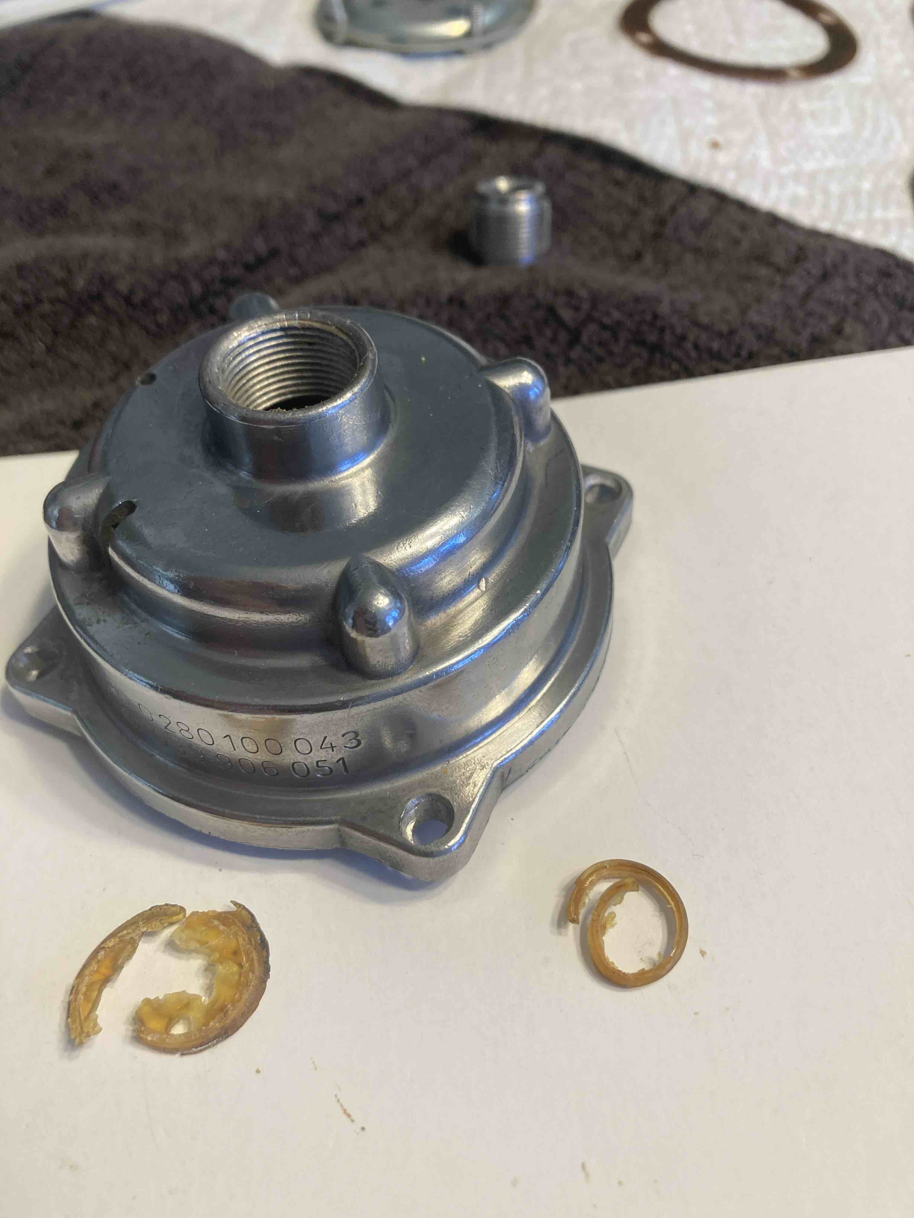

I am in the middle of rebuilding my MPS and have a couple of comments and questions .
First when I opened up the unit I found the most difficult job was removing the rivets holding the two halves together.
When I removed the retainer plate to take out the old diaphragm it was in two pieces .

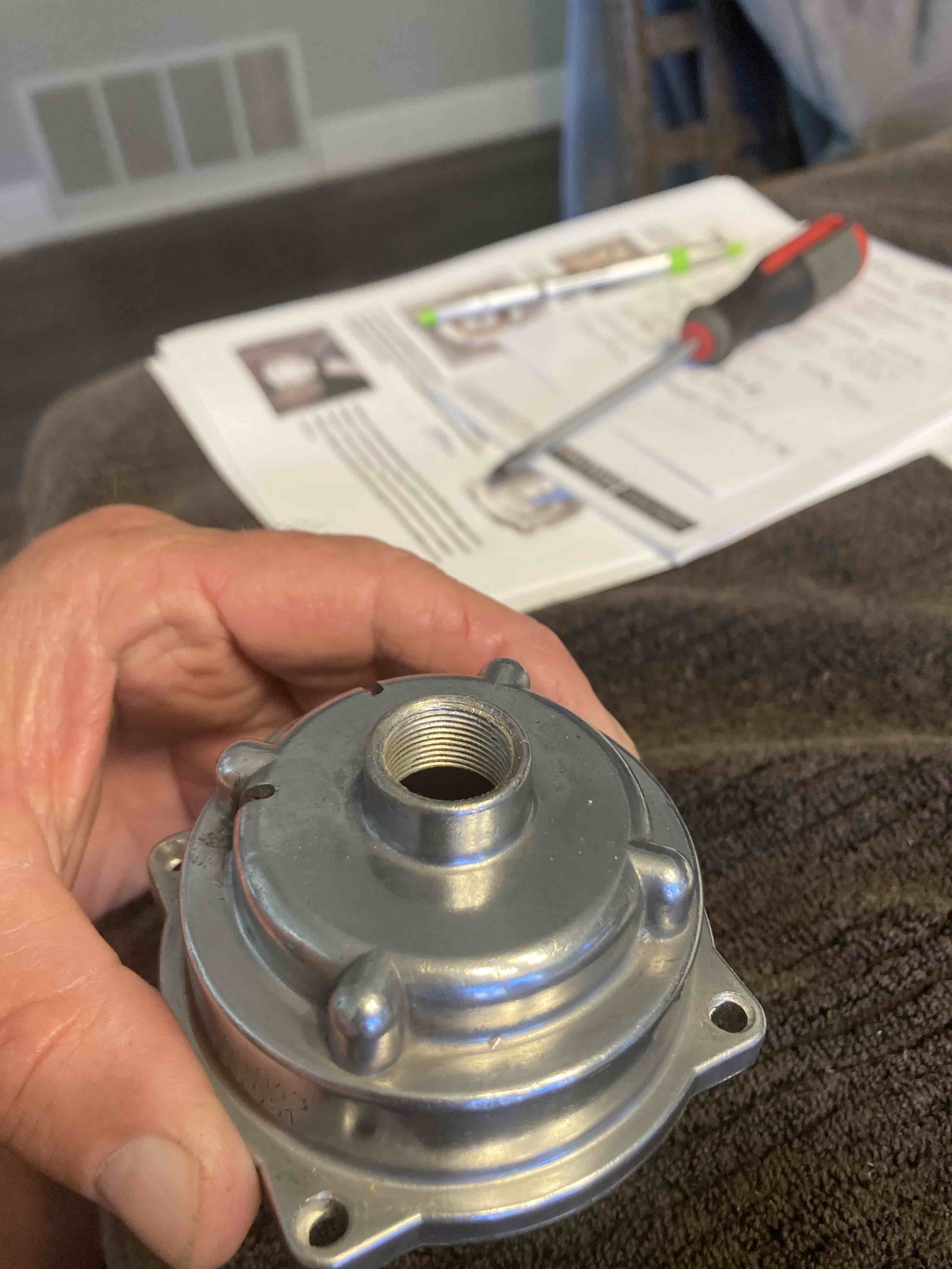

I needed to take two measurements since I was replacing the stop screw , I needed to measure the the stop screw protrusion into the housing . The instruction sheet sent to me by a member had the measurements he must have made when rebuilding his MPS . His stop screw protrusion was 1.97mm and mine only measured 1.72mm.
His inner/outer screw assembly depth in the old diaphragm measured 6.51mm .
Here's one of my questions ?

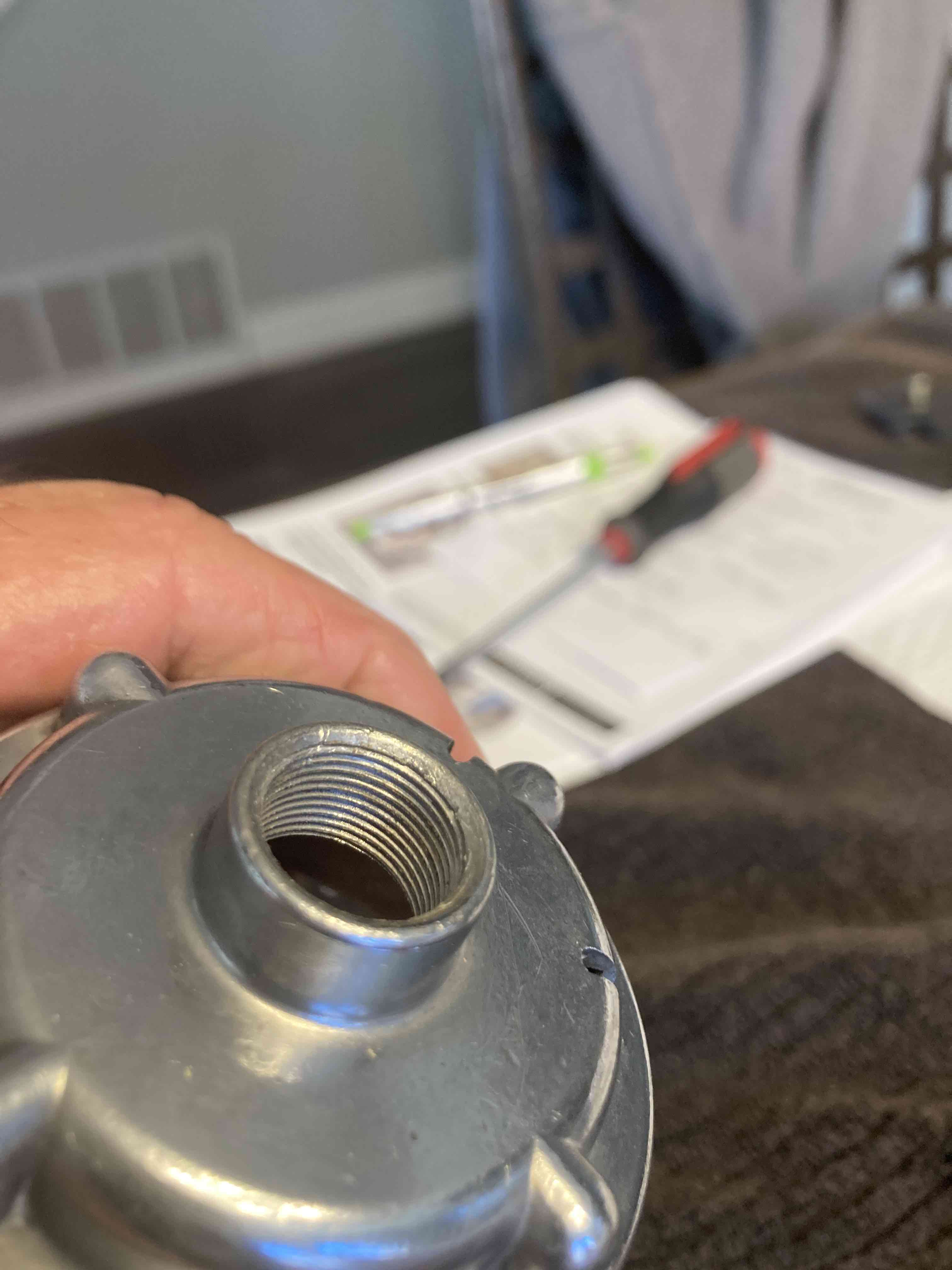

when I measured mine I got two measurements depth to inner/outer screw assembly was 4.03
and depth to the washer outside the inner/outer screw assembly was 5.46mm.
Again there is a difference and since mine was never accessed before (epoxy over screw was not disturbed) is the difference in measurements ok and which measurement should I use I will try to attach a photo or two to help with my question.
this one .
I have not touched either of these measurements yet and awaiting any help/comments.
I think it's this one to the washer on diaphragm .

Well all done . I must say it was easier than I thought I was just making a bigger deal of it since this rebuild was my first . I actually found by using a heat gun to soften the epoxy it came out very easy . Even the threads cleaned up nicely with a little heat and a pick , no need for a tap to chase the threads came out nice and clean the screw removed easily . Here's a few more photos . Now for the fun part ,tuning my car to run better for my 2056 motor . More things to learn for me
