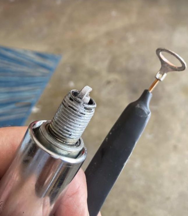

This is another change you’re completely neglecting.
Generally speaking - you’ll find NGK and other spark plug makers recommend against anti-seize. This is because the plug needs a good ground path to the head to spark.
Anti-seize also modifies the torque spec - so the spec they give you is for no anti-seize. Torquing to their spec with lube can lead to stripping threads.
Now for reality. I use copper based anti-seize but very sparingly (not like this photo). You should get a good enough ground from contact between the plug shoulder and the head. But - - you’ve also added the CHT sender in the mix and ground path. If the CHT sender isn’t allowing a solid connection between the plug and head - ground path could be compromised.
I’m not posting this to shame you but rather to get you thinking about how many changes were introduced since it ran last and that things as simple as too much goop and/or a improperly seated CHT sensor could be causing your misfire / engine rocking that you initially described.
Note: if you don’t have a slot cut into the head to allow that CHT to seat properly, it often takes some creative bending to get that CHT down into the spark plug pocket correctly.
