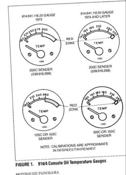

A while back, I asked about how hot a 914 should run on a VDO gage with no numbers. Responses said, I need to look at the sender to see if it matches the gage. I had a chance to get the sender out so here it is.
After a high reving drive on a warm day, the temp went close to the red zone. Maybe a needle or twos width to the red.
Do I have a matching gage with sender?
Thanks!

Superhawk996
post May 9 2025, 08:09 PM
Posts: 7,767
Joined: 25-August 18
From: Woods of N. Idaho
Member No.: 22,428
Yes - correct 200C sender.
