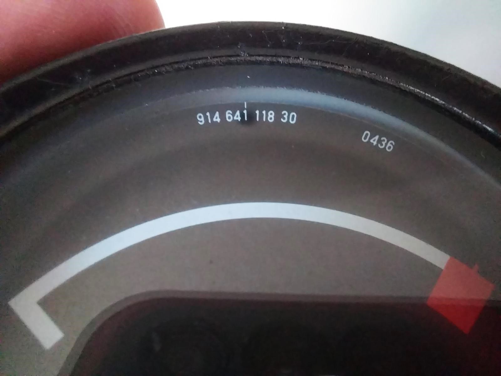

A while back, I asked about how hot a 914 should run on a VDO gage with no numbers. Responses said, I need to look at the sender to see if it matches the gage. I had a chance to get the sender out so here it is.
After a high reving drive on a warm day, the temp went close to the red zone. Maybe a needle or twos width to the red.
Do I have a matching gage with sender?
Thanks!

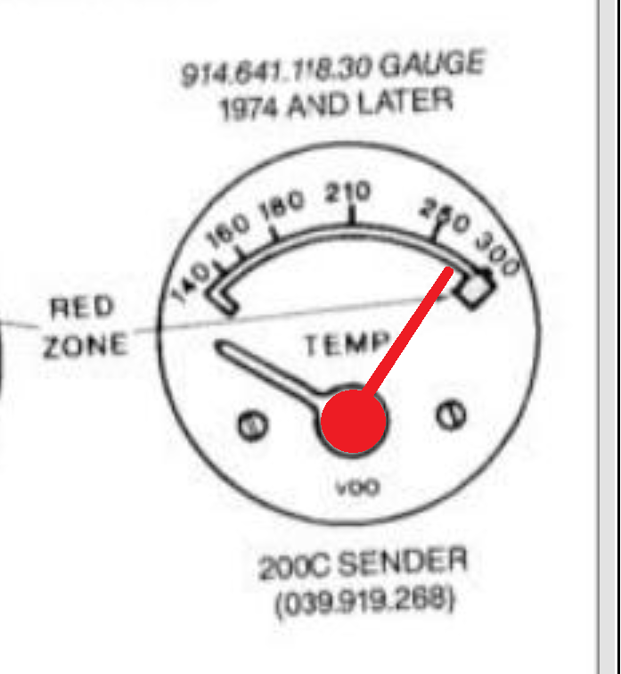

I just checked my gauge and it matches the sender according to the diagram. So, my car, if your drive it briskly, is running at around 280 C. Maybe, a longer drive, it would keep going into the red. I don't know.
Why is my engine running so warm? It's very clean, no crude blocking anything, new carbs, fresh oil. All tins in place.
Thanks for the responses.

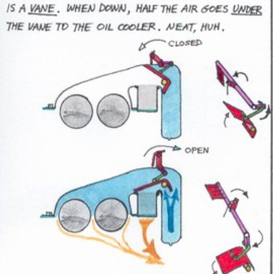

Flaps - has some DAPO removed your flaps? Is the flap on the 3/4 side properly connected?
Thermostat - is your thermostat adjusted properly. See graphic
