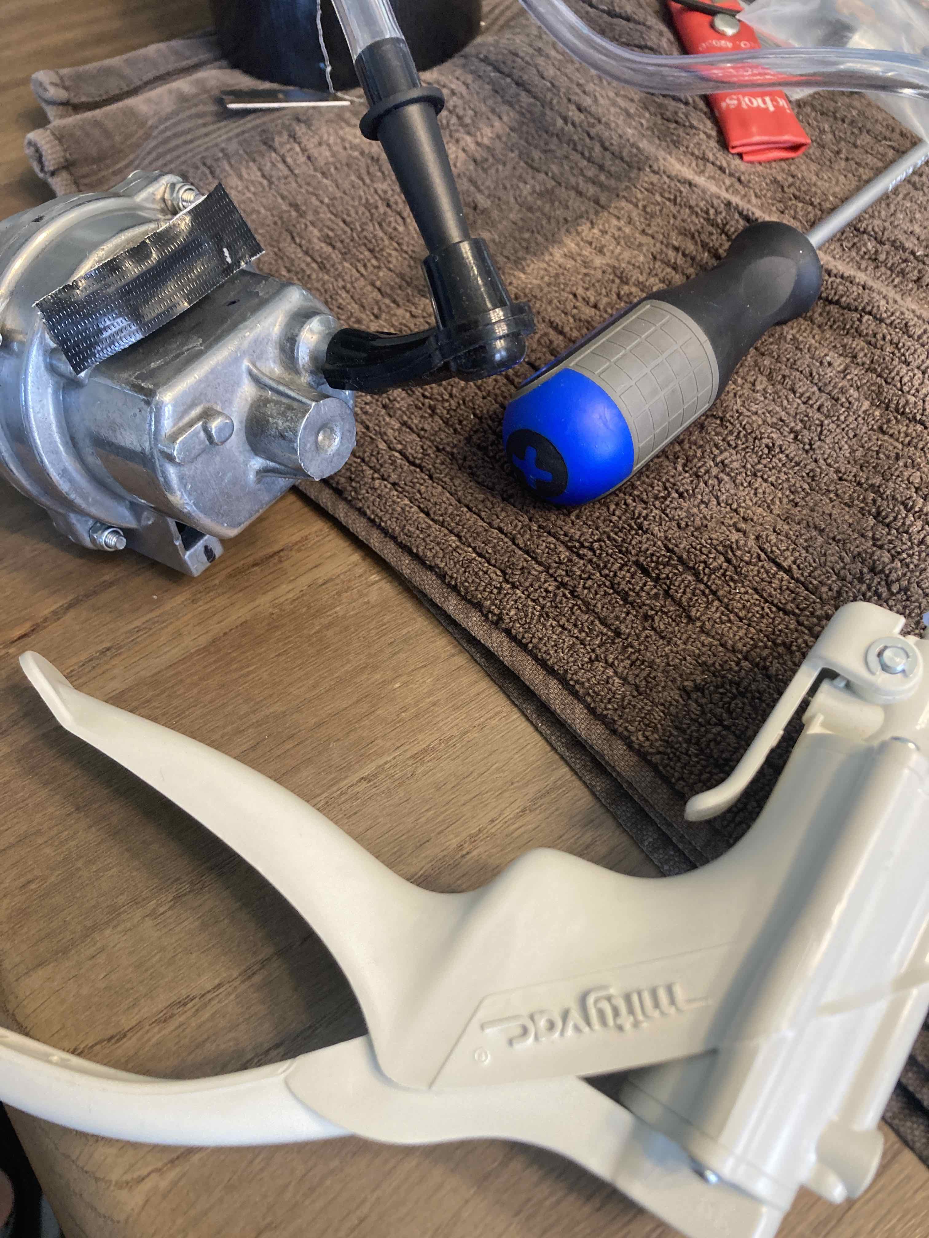

I am still having leak down issues .It's a lot better but not ideal . How about if I put the old square gasket back in ? What's your opinion on that ?
I did all the things Jeff recommended but still had significant leaking .
I figured if the connection plug could be leaking at the base why not through the pins so I covered the plug with Gorilla duct tape .Here are my results after that last fix .
Next I am going to go around the case halves with electrical tape and put the square ring back in . I will update soon .
