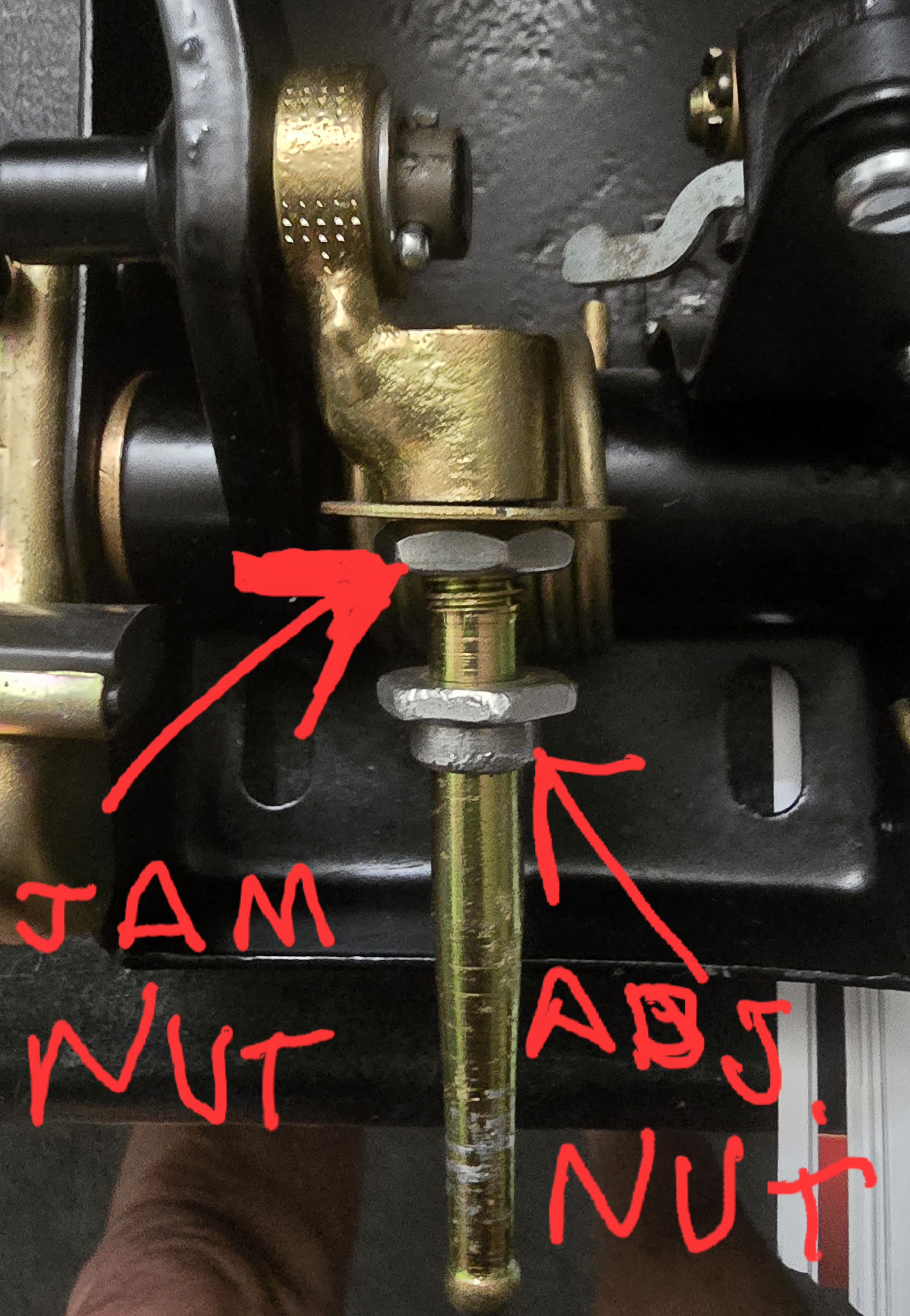

You don't need to pull the cluster to check the depth. The rid should allow about 1" brake oedal movement before it moves the piston on the master cylinder. That is per the factory spec. I like less play. Loosen the jam nut on the brake rod and turn it to extend the lenght. You should be able to feel when it is starting to move the piston. The tmrod has a nut to turn it but it is best done by hand.
By any chance was the previous master sized. I see brake rods that are bent on a lot of pedal sets. I think that they bend when the master is siezed and extreme force is used to depress the pedal.
