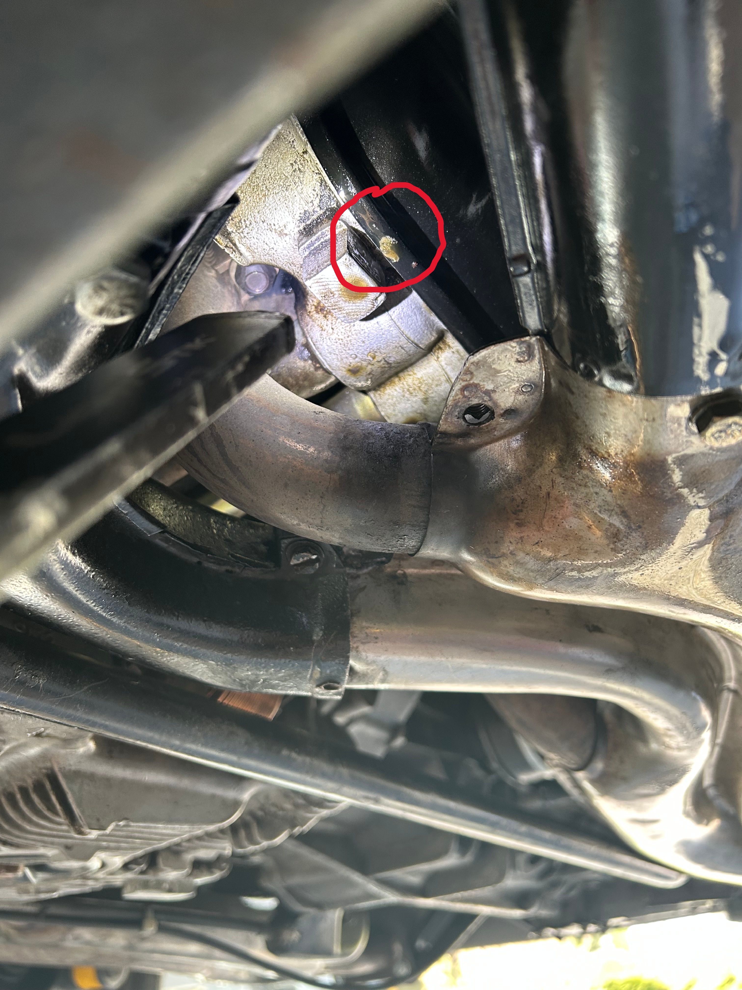

So I started the car yesterday. Ran it for a few minutes and then brought it on the lift and took a look to find the leak(s). For now, I really feel it is coming from the valve cover gaskets. I was actually able to see oil dripping from there so I will try to get this to seal first and then retest everything.
Should I get a new gasket or I can reuse the one that is there if it is still in adequate condition. I used Victor Reinz gasket.

PaIsa   So I started the car yesterday. Ran it for a few ...   May 15 2025, 05:06 AM
