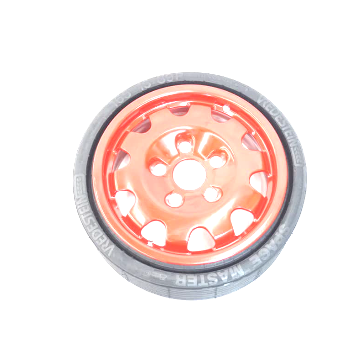

Hello, needing a compact spare for my 914 six with flares. Currently, I’m running 15 inch wheels but I think in a pinch this could work. I think my rears are 225/ 60 17. Front 195 65 15 Pirelli cn36.
See pictures for rim and Tire six. To get me out of the boonies and back to civilization do you think this wheel would work?
Very reasonably priced under 100 bucks and basically new.

I've inflated 3 of these old Porsche space saver tires and none of them cracked. Lack of exposure to UV rays (if stored properly like in the car) made them last longer. I think they would get you off the highway to a gas station in a pinch at 45 mph.
There are a few options for refurbished (SMC) or new 928 emergency wheel which I think is a 16" but can't find details. Here's one for $430
I should also mention Veredstein still makes them as of a few years ago. But they are typically only avail from a Euro dealer. Finding someone to mount them is also a challenge. It's possible, but usually a hassle.
