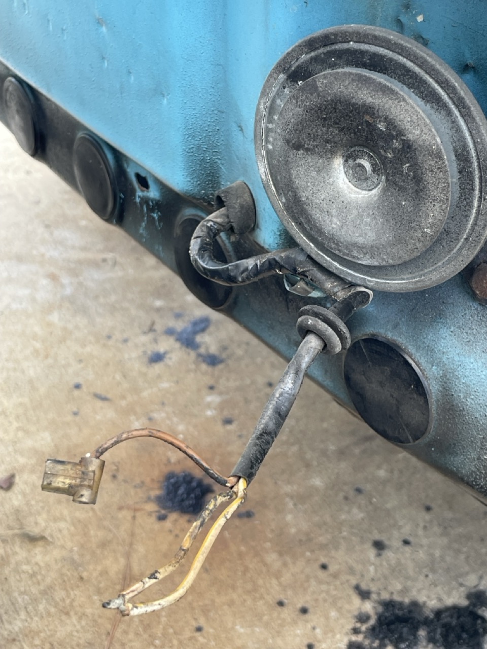

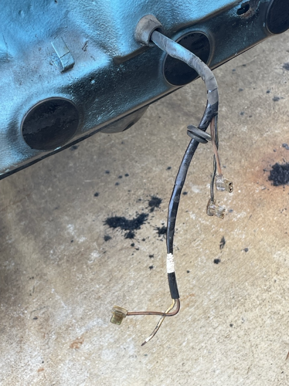

Spent the last week refinishing the ground effects and the bumpers. Next step is to put fog lights back into the factory spot. I have the new 914 Rubber fog lights grilles and led lights to fit, but need to know if these are the right wires. And also if they are, how are they operated? Not sure if this car came with them from the factory, the car already had aftermarket plastic grilles in it and they were cracked and broken. My interior only has one light switch that is a pull switch that activates the headlights. I put my volt meter on the brown ground and the white/yellow positive, and no voltage going to them when light switch is pulled out. Are these the factory wires, or something else?

Thanks guys! So I’m assuming they wired all the cars, but only put the fog light kits in certain models. I only have one dash switch other than the hazards, and it only operates the head lights and running lights. I placed my volt meter on the yellow/white and brown grounds and could not get a signal by manipulating the headlight switch. I have a 5 pin Bosche relay and 14 gauge wiring to run a new set up to the new led driving lights, so I guess that’s what I’ll be doing later today.

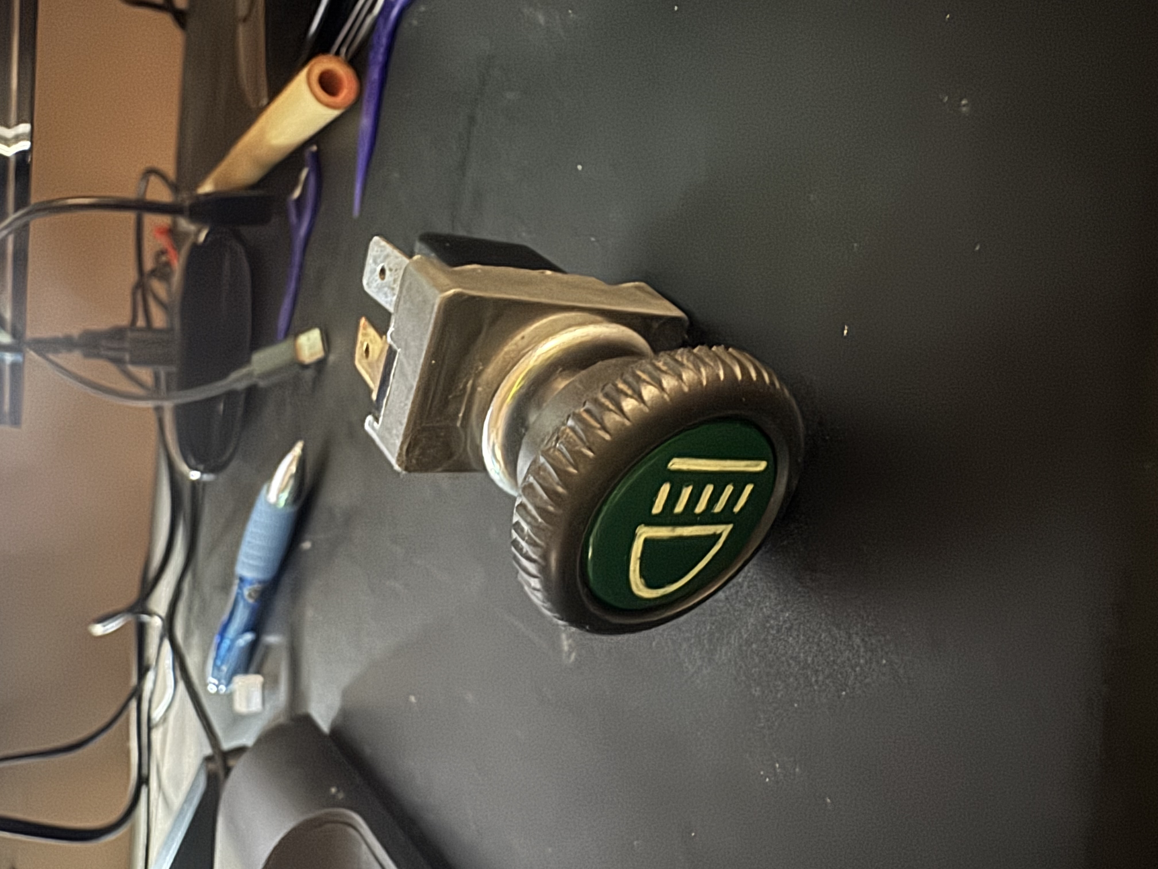

All I had to do is add fog lights to the front and a this switch (one like it) to my car
and the fogs worked. No relay and no wiring. My car is a non appearance group , no sways no fogs no nothing. Switch goes next to you emergency switch, the wiring for the switch is right under there.
