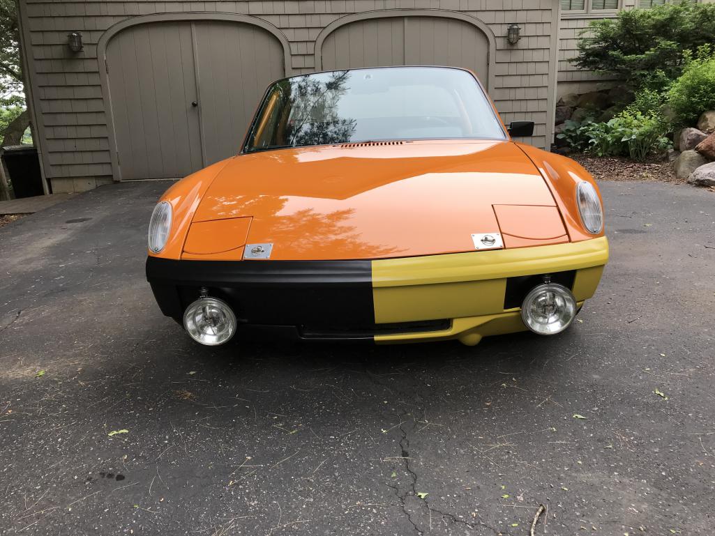

Show Us how those headlights work .... interested.

Well, they don't.......30 years ago to much weight. so the front driving lights work but I am adding the Cibie Oscar hood lights this spring. I like to fabricate. Best, MarkAttached Image
