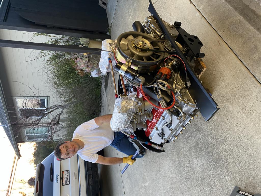

Pic of my engine going in with my strong youthful sidekick
