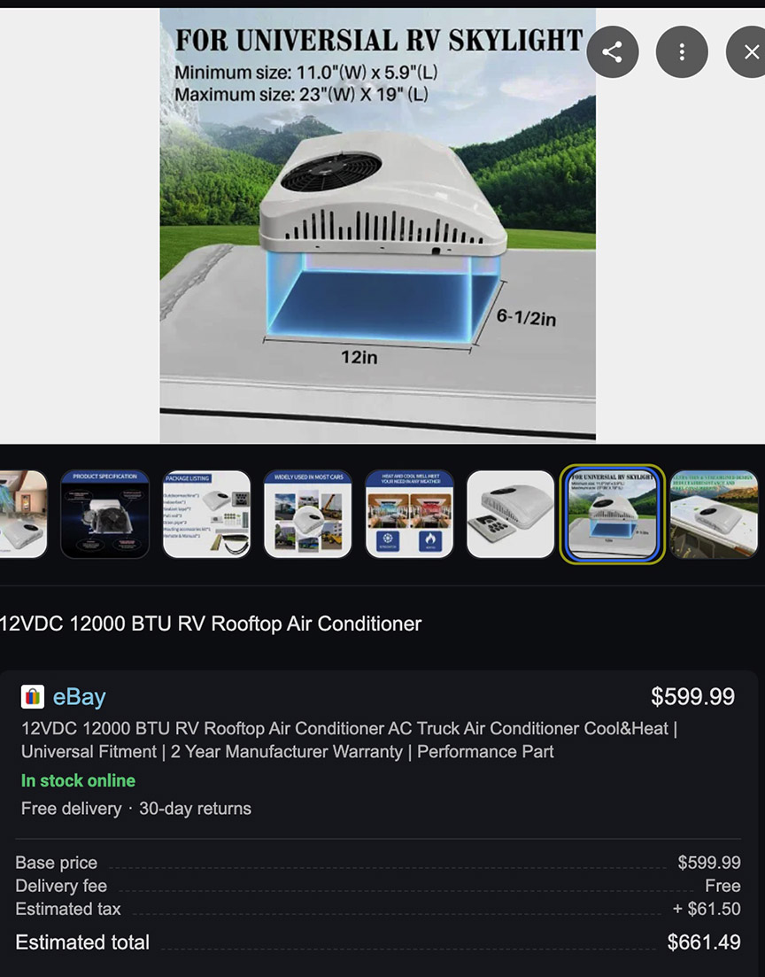

On Elwood (the original six) I have considered upgrading the alternator, and adding a small 12v RV rooftop AC unit to a spare targa top. Drop the wiring down to the battery, and you get cold air in the car without cutting up the front trunk.
Yea, it would look a bit silly, but it could be easily removed and replaced with the stock, unaltered top.
And it Texas, AC is not a luxury. It is a necessity.
But I have to get this idea by the co-owner of the car. (IMG:style_emoticons/default/driving-girl.gif)

Clay, this is not a bad idea in a pinch. Plenty of tops for 914s but you may get a cerebral freeze out. Still around 5 inches tall.

Shivers   @Superhawk996 That’s funny Phil :D 12V 4400...   May 21 2025, 08:12 AM
