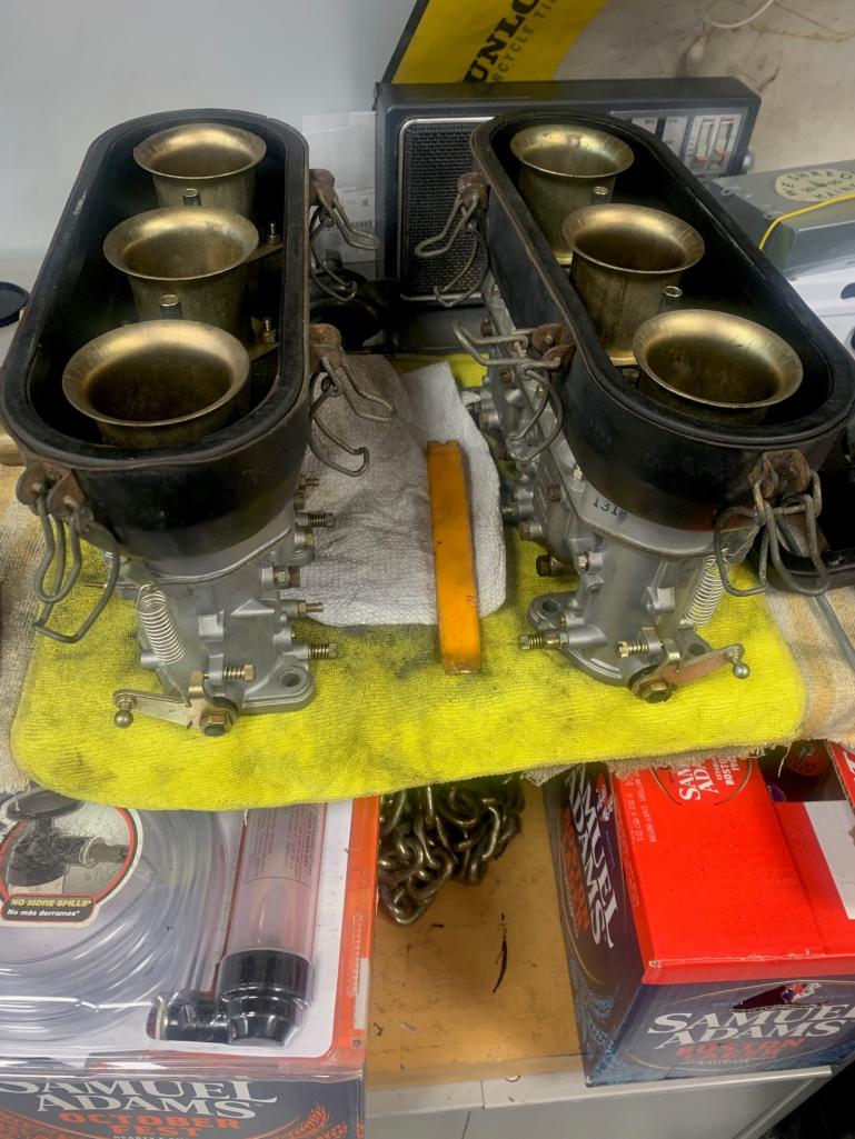

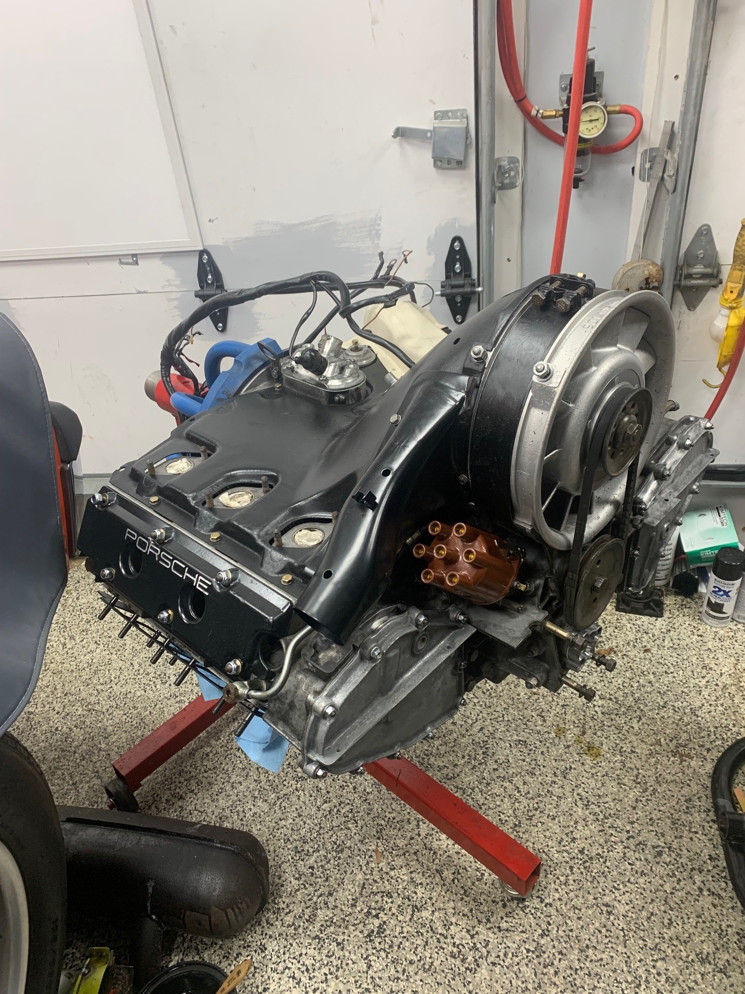

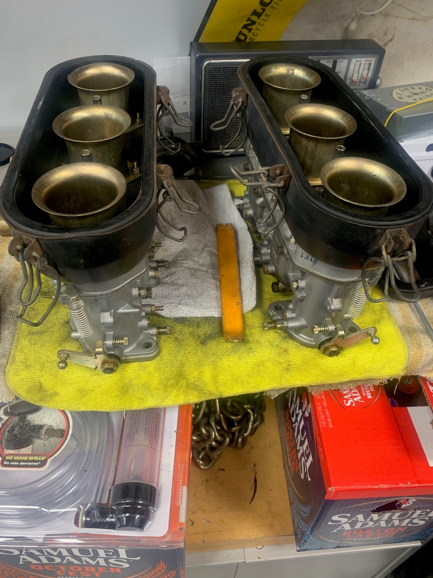

Engine Ready for the tin, looking better,
Moving on to the carbs...........
