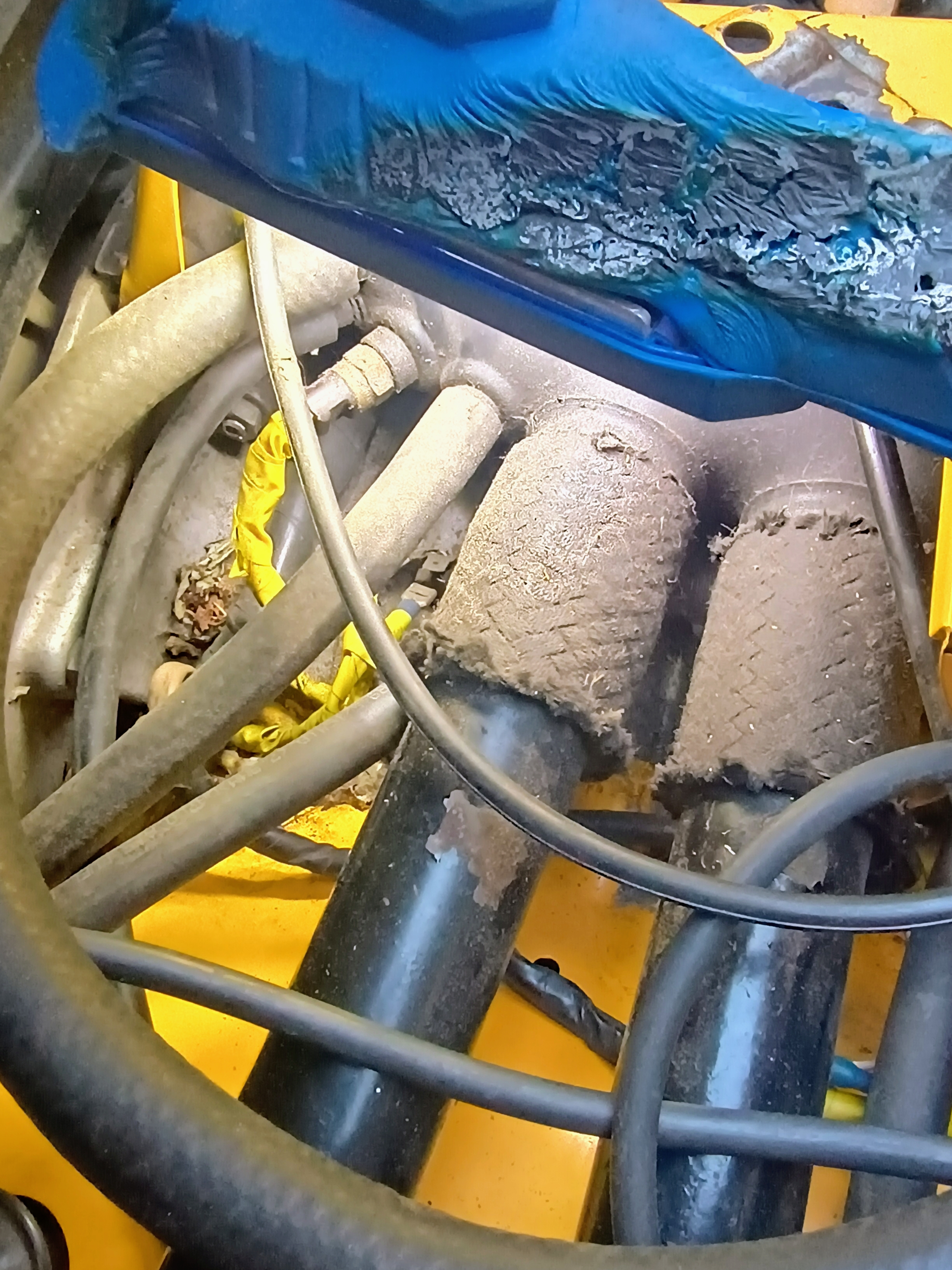

Evil Herb's has complete new FI fuel line throuhout.
so checking thru the 914 list (IMG:style_emoticons/default/confused24.gif)
Found a kinked fuel line under the tank, dangnubit (IMG:style_emoticons/default/headbang.gif)
Inspect FI wire harness,
found several cracked casing, (taped over)
Cobblejob wire repair to one of injectors wires
all the 914 Bugs I can come up with to check for.
Herb's starts up after a couple of try's
as it's began to warm up and starts purring,
Great idle!
but, Gutless, horrible throttle responce,
Finally found out,
Herb's is running on Two cynliners !
#3 and # 4 injectors are not firing do to no pulse from FI harness.
Is this the brain / computer issue?
Sorry for the long intro,
Evil Herb's story,
which I will write another time,
remember
everything works,
Spark,
Fuel,
injectors,
Just no pulse at #3 n #4
weird (IMG:style_emoticons/default/blink.gif)

For folks don't know where the Three Groung Thingie.
