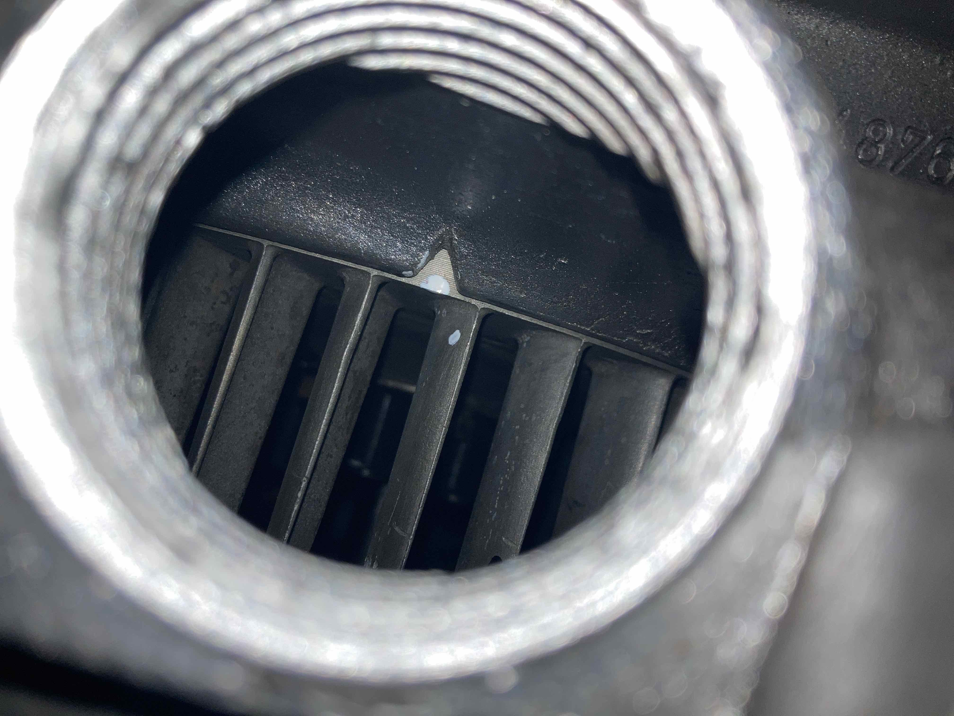

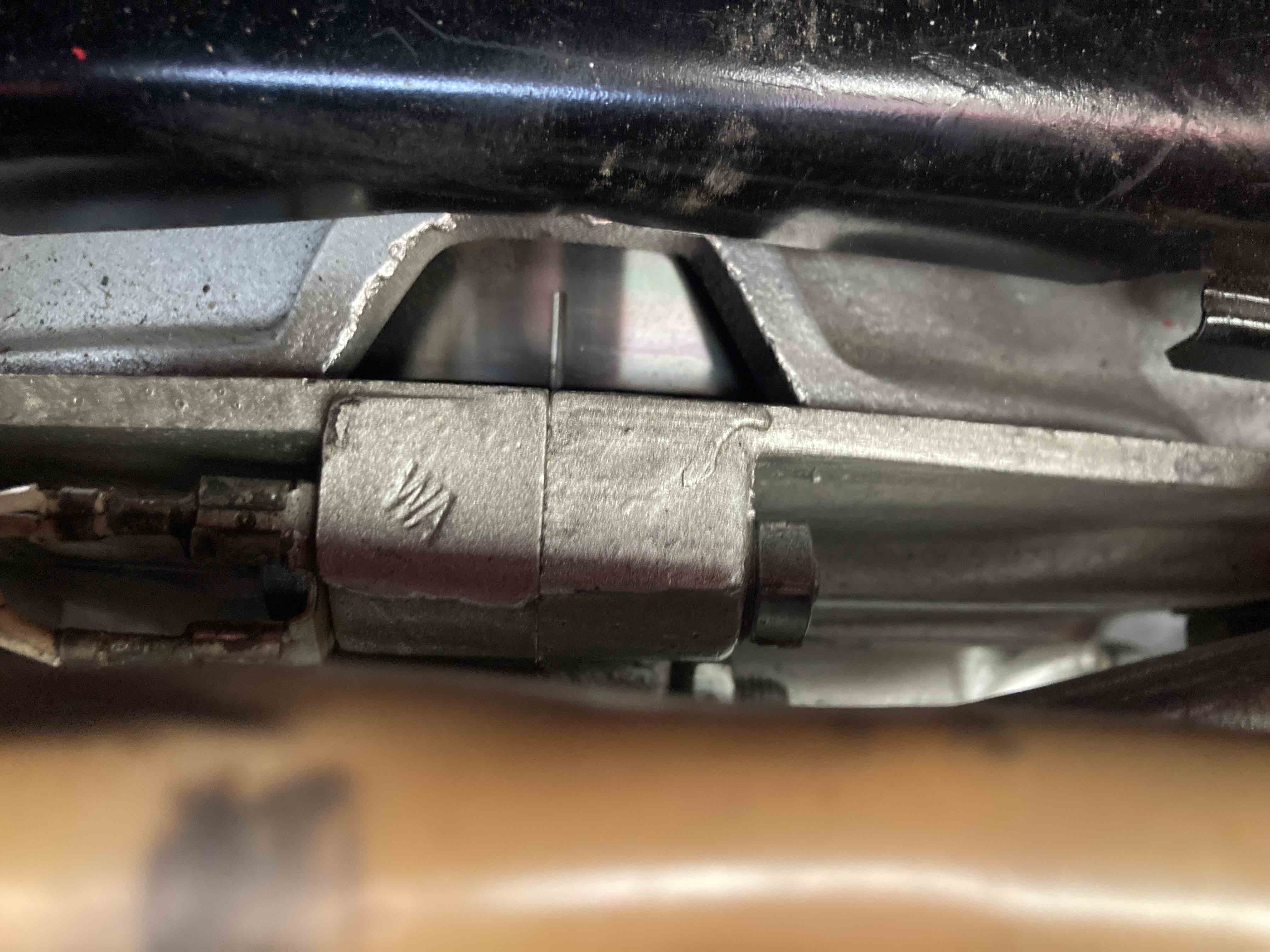

Thanks for checking in on me @Superhawk996 ,
I have been taking a break as I let a lot things go working on my car and need to get caught up . I have more time this weekend and next week to give it one more shot at getting it running so I can drive it to the WCR in a few weeks . I made up a remote start switch to help me ,I have a good timing mark on my flywheel that I can see now for timing . I still have the Pertronix in the dizzy but am thinking of going back to the points/condenser again just to eliminate any possibility the Pertronix is a part of the problem .I saw the break in one of the ground wires and have purchased some new connectors and a brass wire brush to clean up my connections . I actually would like to see if anyone locally has a good MPS just to eliminate if my new problems are coming from it . At the WCR I believe Jeff B is giving away a couple of gift certificates for a raffle so maybe I'll get lucky and win one . I can use it to offset the cost of a new wiring harness if I don't find my problems . Based on the flywheel timing mark I added a white dot on my fan wheel to help . I believe my advance on the dizzy is ok ,I connected the mighty vac and can see the advance plate moving inside my dizzy . I will add an update after the weekend.
