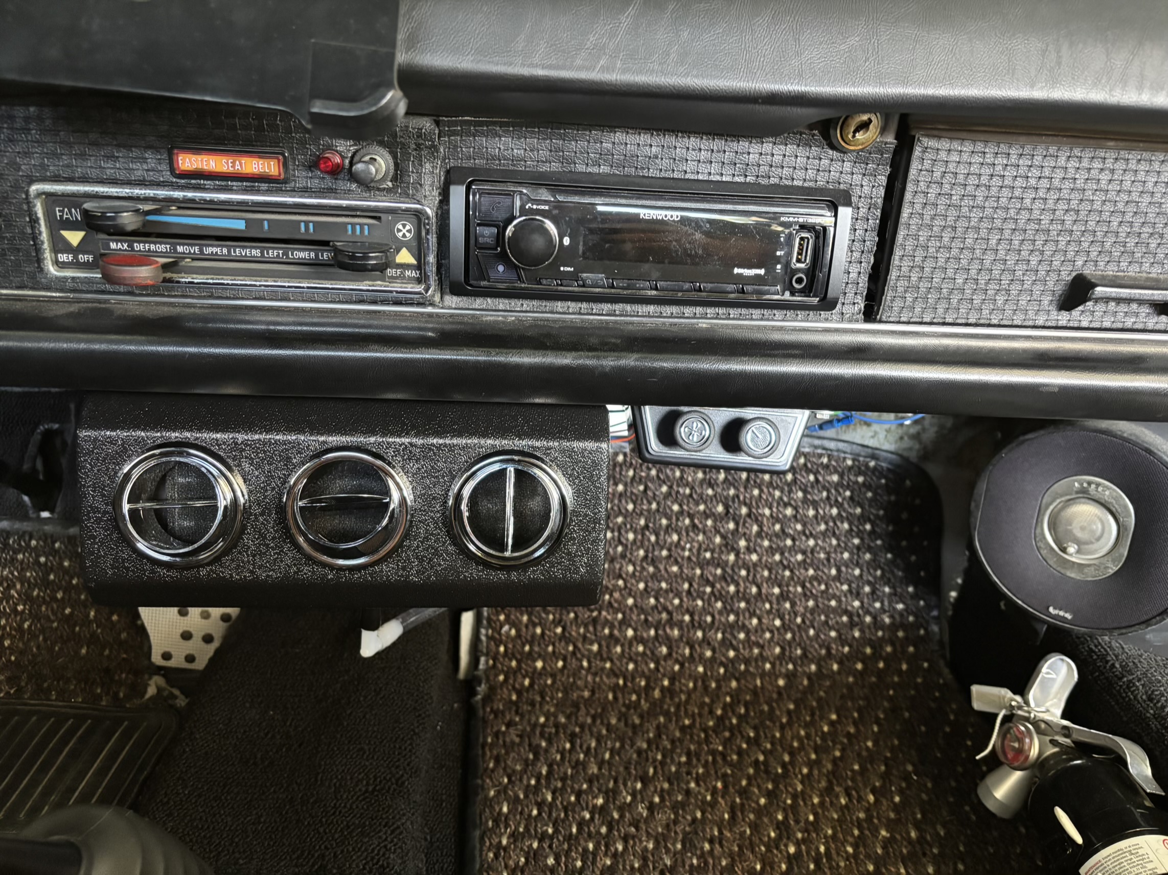

I did some more testing at 70 degrees in the garage. At the medium setting (65 amps) I get around 38 degrees at the vent. With the low setting (42 amps) I get around 42 degrees at the vent. Since my stock 3.6 alternator is only 115 amps, I will leave it at the low setting until I upgrade the alternator some day. Since the evaporator is an under dash unit, it will recirculate the air anyway.
I love the under dash evaporator. Doesn’t take that much room.

Can I see a pic of the under dash evaporator in the car?

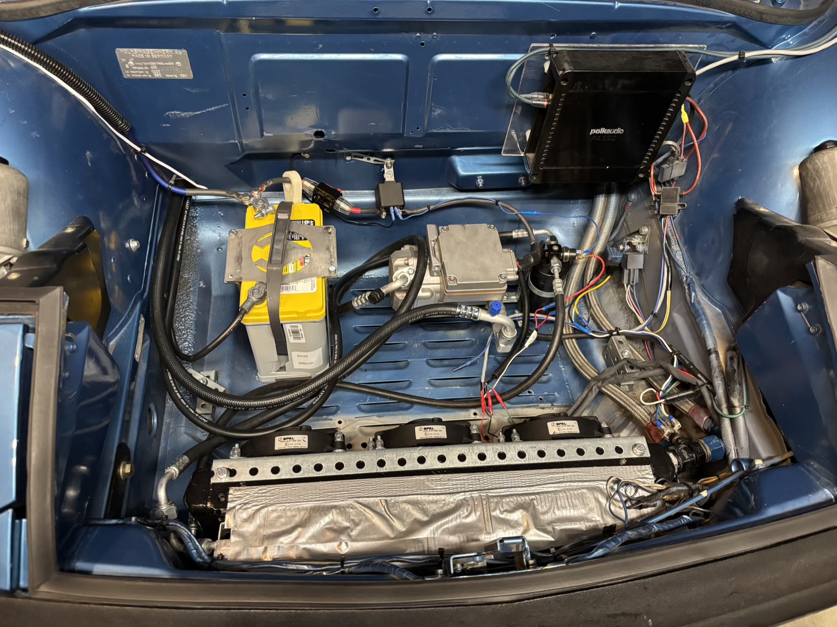

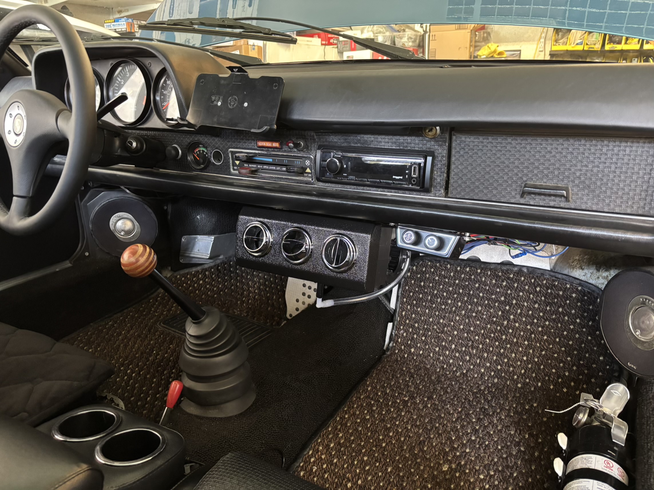

Here’s a couple more. It is a little into the passenger side. I added a second battery in my troubleshooting, to see if the long wire to the battery was the problem. It wasn’t the problem, but I left it anyway. My original problem was the pressures were all over the place and it would trip my 100 amp breaker. I originally took the same evaporator, ripped the guts out and mounted it on its side in the center console. It was a nice setup, it didn’t work. You can click on my blog for pictures of that setup.
Next, I will install a cut down deposit box underneath it and mount the controls underneath the evaporator.
