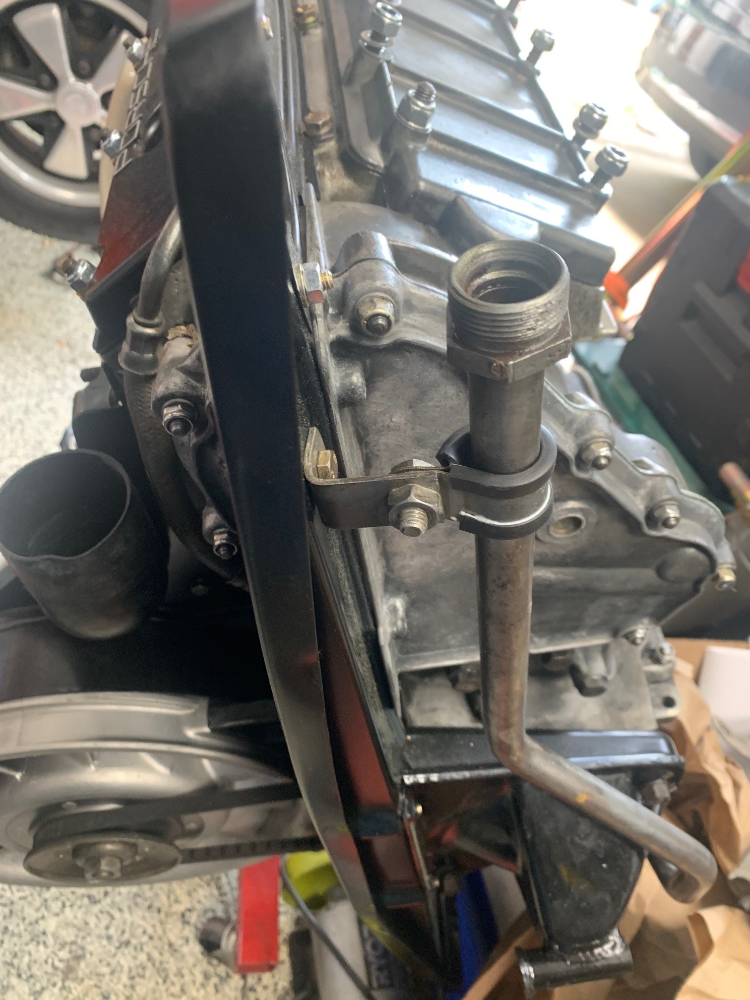

Looking for pics of correct six hard engine oil line attachment to engine. At this “age” so many variants …….trying to get it accurate so appreciate any pics that show clamps/bracket locations. TIA

As per factory, the L bracket attaches to the sheet metal..

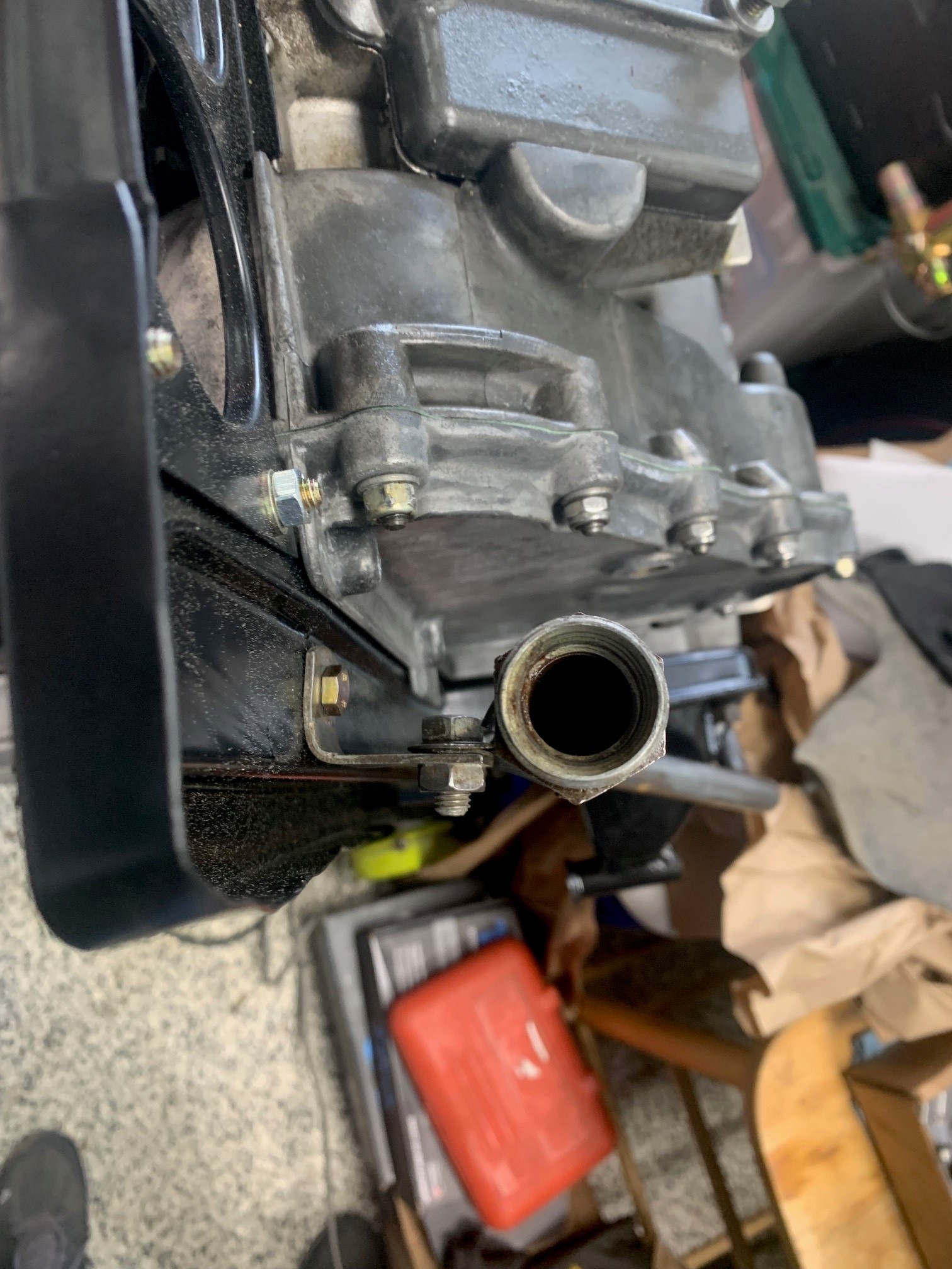

QUOTE(sixnotfour @ Jun 1 2025, 04:43 PM) *
Here is how I attached it - I believe that the "L" bracket attaches UNDER the tin.

ctc911ctc   I was working on this VERY issue this evening, I...   May 30 2025, 07:31 PM

rgalla9146   Hey Terry Gandalfs picture shows the cor...   May 31 2025, 07:32 AM
ctc911ctc   Hey Terry Gandalfs picture shows the co...   May 31 2025, 07:25 PM

sixnotfour   As per factory, the L bracket attaches to the shee...   Jun 1 2025, 04:43 PM
ctc911ctc   As per factory, the L bracket attaches to the she...   Jun 1 2025, 05:56 PM
