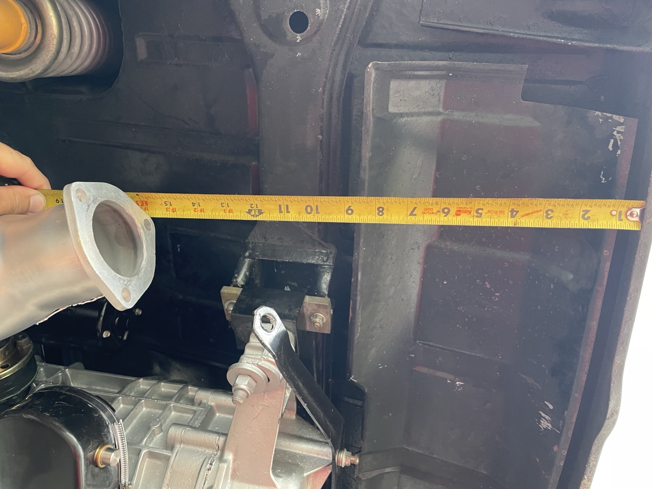

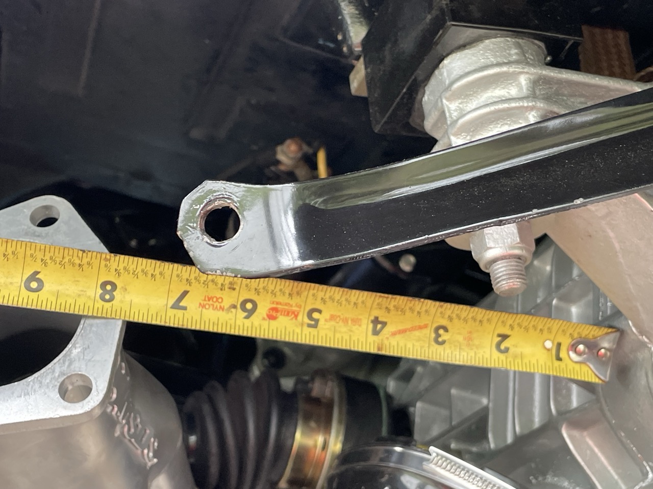

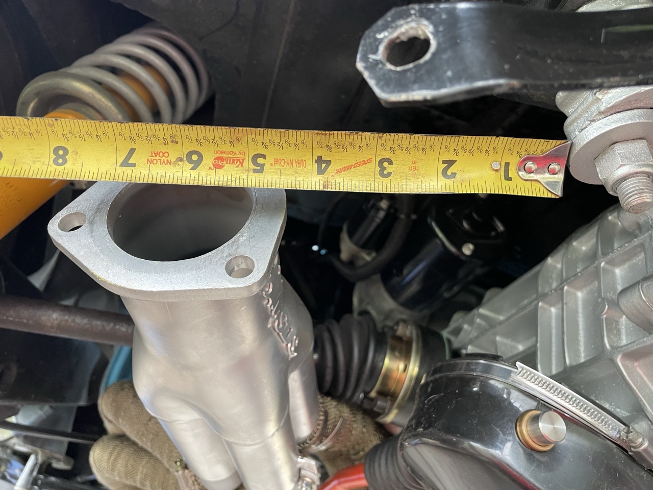

Header reference

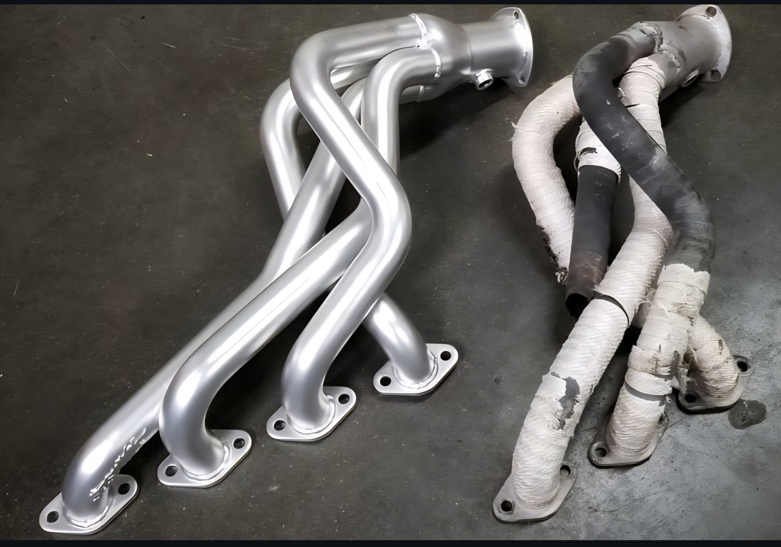

Just a technical service bulletin for folks using 'Header Wrap...make sure that the mfg of this product will warranty the exhaust system from corrosion, disintegration of the steel* / as mfg's (including MSDS,inc.) do not cover the product loss.
*Also known as IGC, intergranular corrosion. With header wrap the issue is also increased by trapping moisture + heat soak with no exit path but being trapped.

My $.02
The steel will seem to crystallize and break like glass, usually under severe use... Why race headers are made from stainless, inconel.
