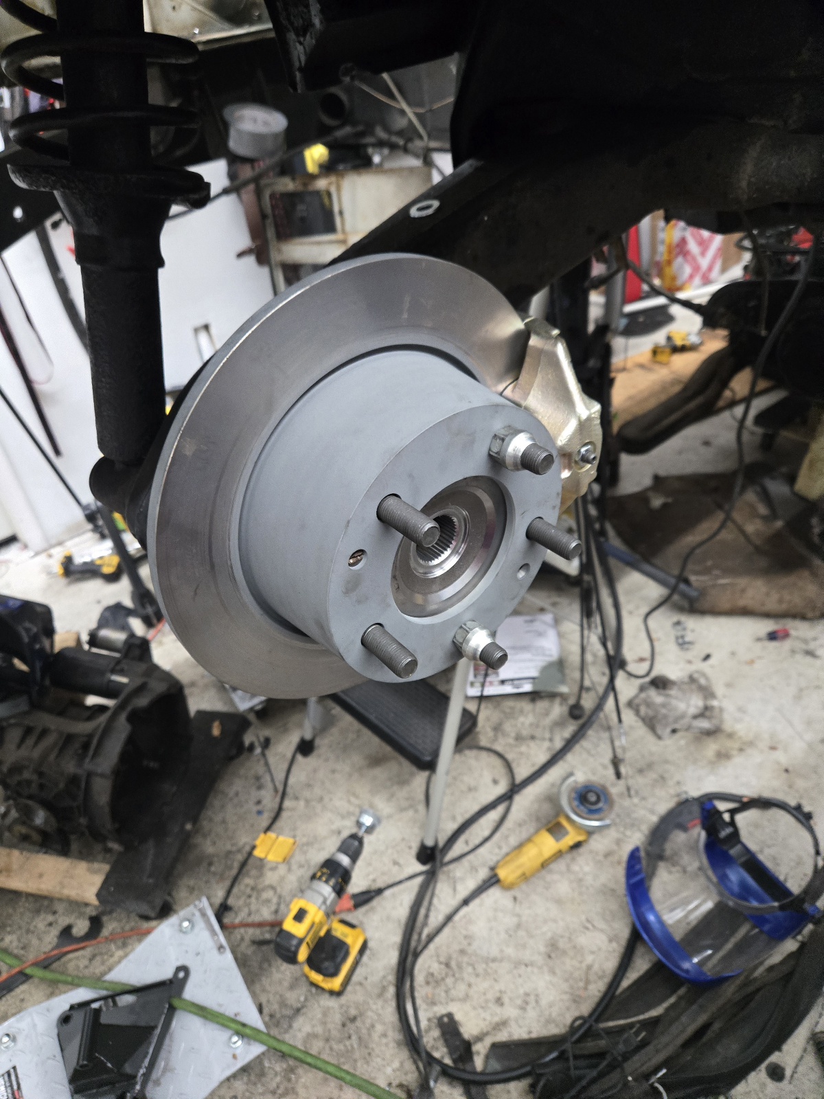

Ok so im back from the Ruchlos Rallye. Got to hang with some world friends like Paul, Travis, Dave, Don, and Dion (pardon if I didn't mention you by name and you were there). The best Rallye and awesome roads in WV. Anyway back to this S-show. I did manage to press the hub in slightly more. I think I was bottoming out against the backside of the hub instead of getting a few more mm through the bearing. Caliper looks positioned well and the Sebro rotor has good clearance. No need to shave as some have stated.

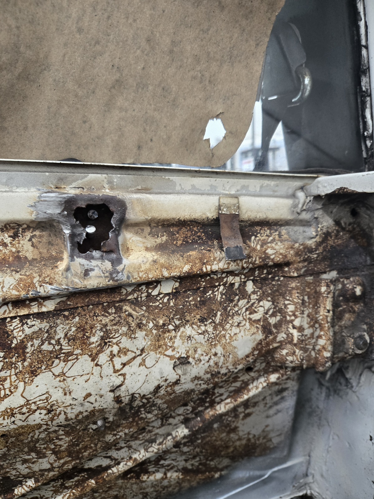

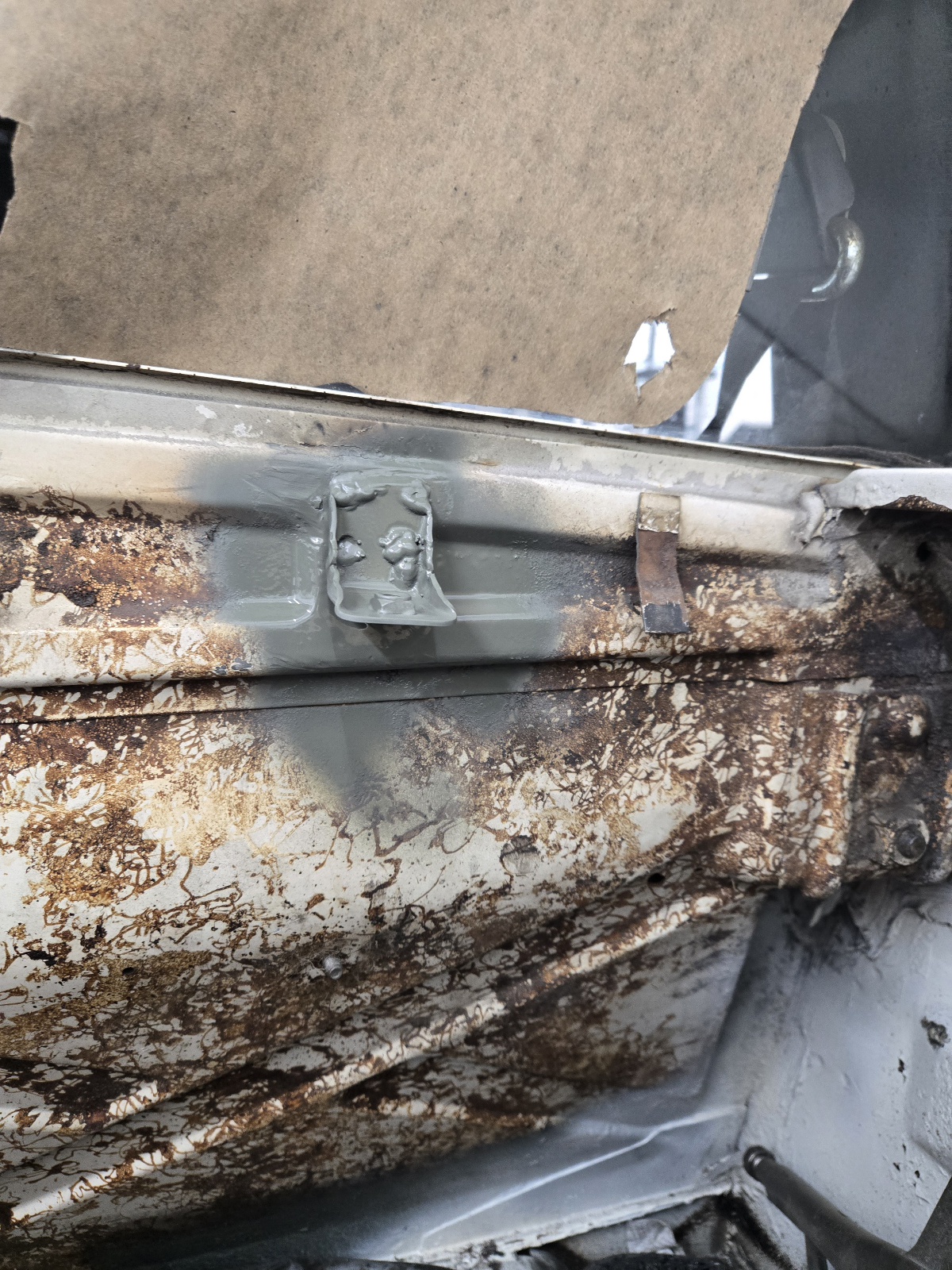

Since I was busting out the welding setup I decided to tackle the engine lid mount. I did both on my last conversion and it's not a bad job, well if you have the metal to weld to. This job was not pretty, but will securely hold the engine lid better than the previous hack job. The right way would have been to cut a small piece to repair the hole, but im not a great welder, this metal is thin, oh and im not even an average welder.
