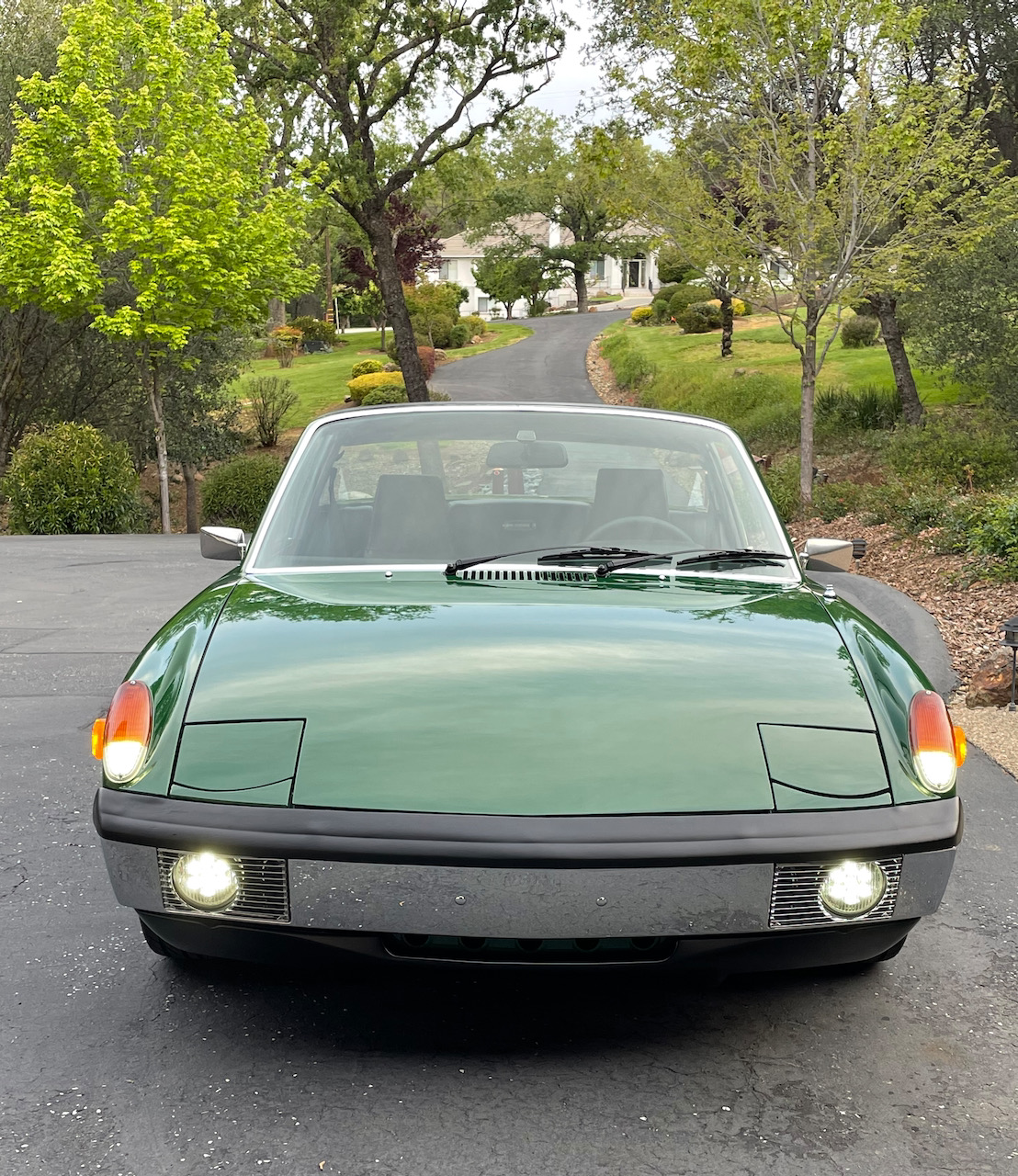

@cgnj @chmillman
Here are the Spokeworks LED fog/driving lights in my car. They use the stock housing, lens and clips.
