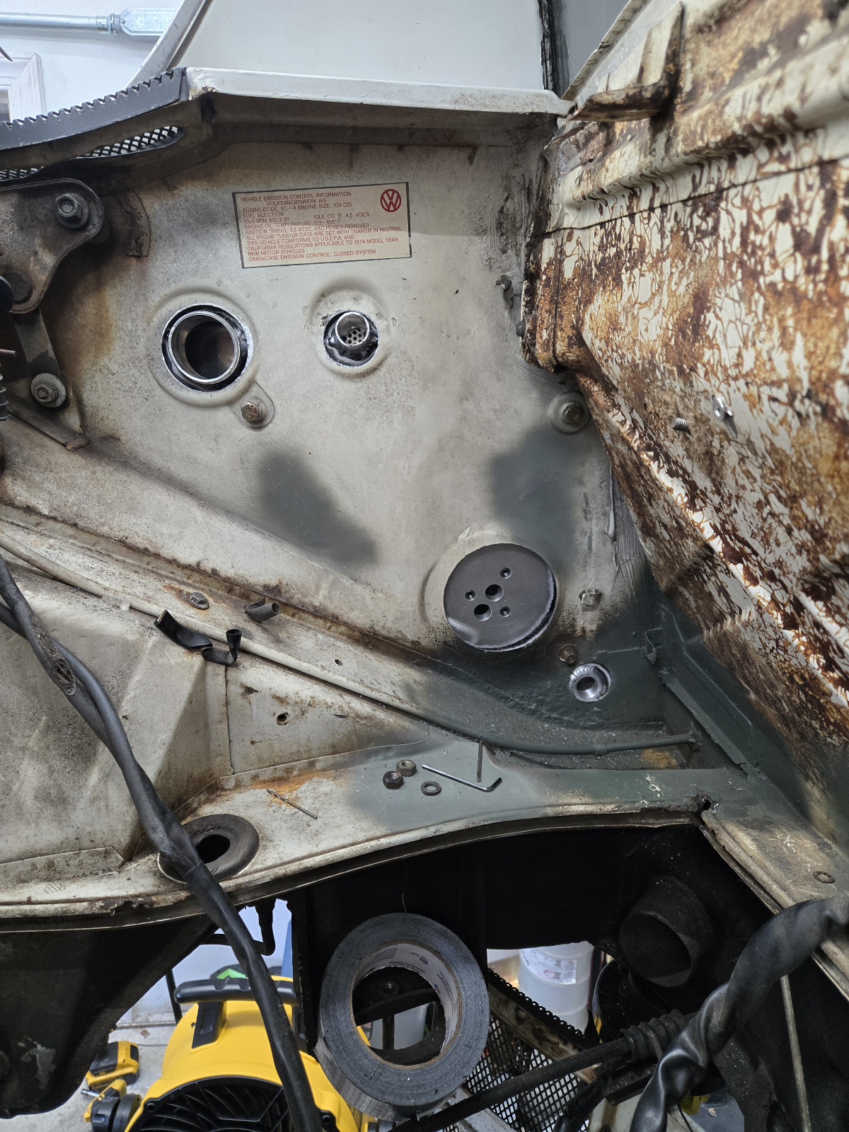

And just like that the tank is 90% in. I need to trim a little on the return line hole. My template must have been slightly off. Went a lot smoother this time than my 1st conversion.
