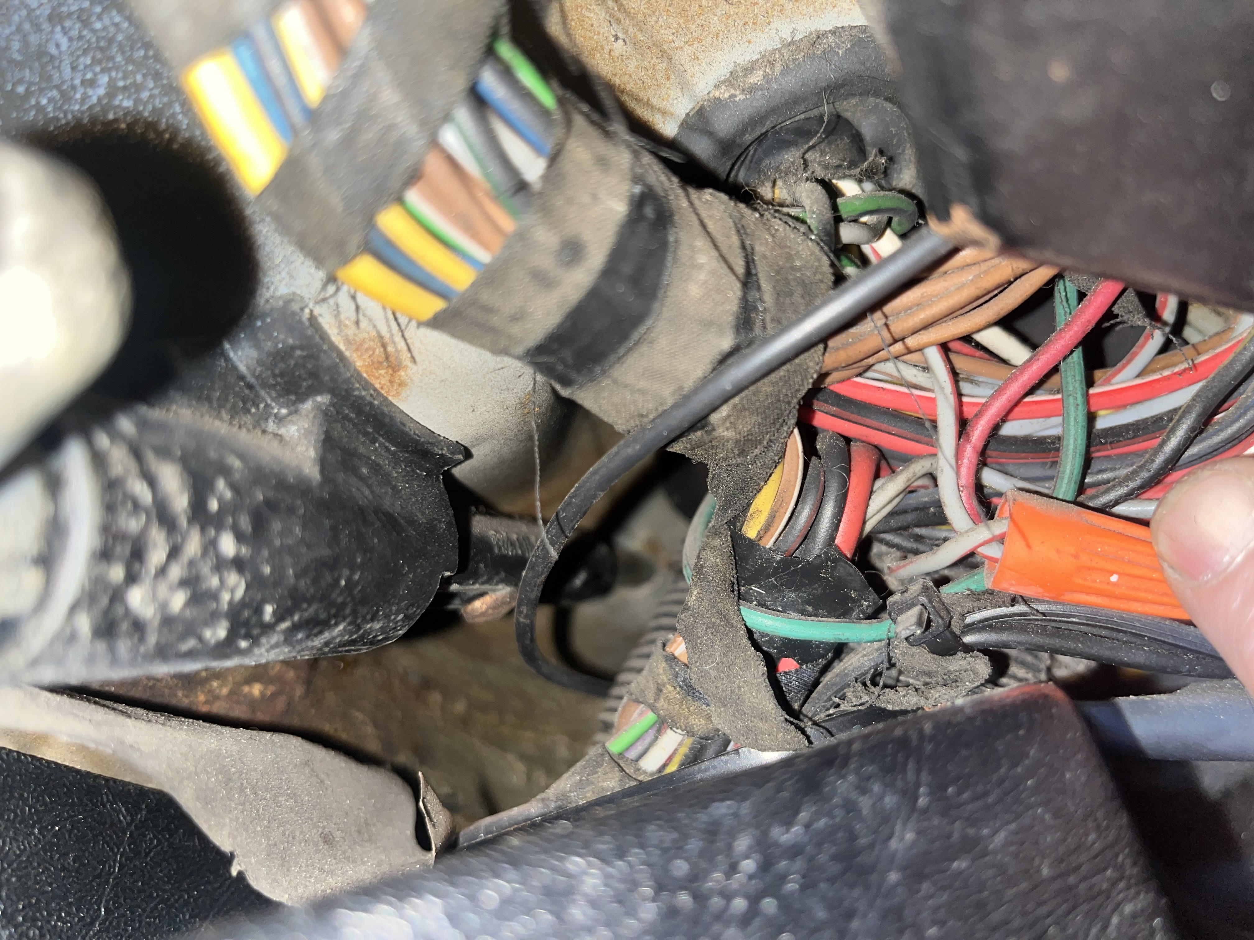

@jim hoyland @Puebloswatcop I still haven’t figured out how to summon people that have helped me out. Don’t know how to underline names. But anyways I went at it today. Put a 9volt battery to the bulb and it is good. I don’t have any continuity from the ground wire with the E brake on. Also did not get 12 V from the other wire connecting to the bulb. This would be with the ignition on.
The number 9 fuse is good. Cleaned and lightly sanded the contact for the handbrake switch. Went looking at the couple wire areas that have been touched by the po. The picture with the red wire I believe goes to the radio. The solid white and solid brown wire that end in female spade terminals, and is not connected. I do not know what that is.
I’m starting to think it’s my turn signal switch. My turn signals work, but when you turn them on and look at the indicator, both right and left indicators blink at the same time. This would be for right and left turns. One of the directions does not cancel itself out. Since it is Father’s Day, and I didn’t want to be in the garage all day long, this is all I have. Any ideas?
