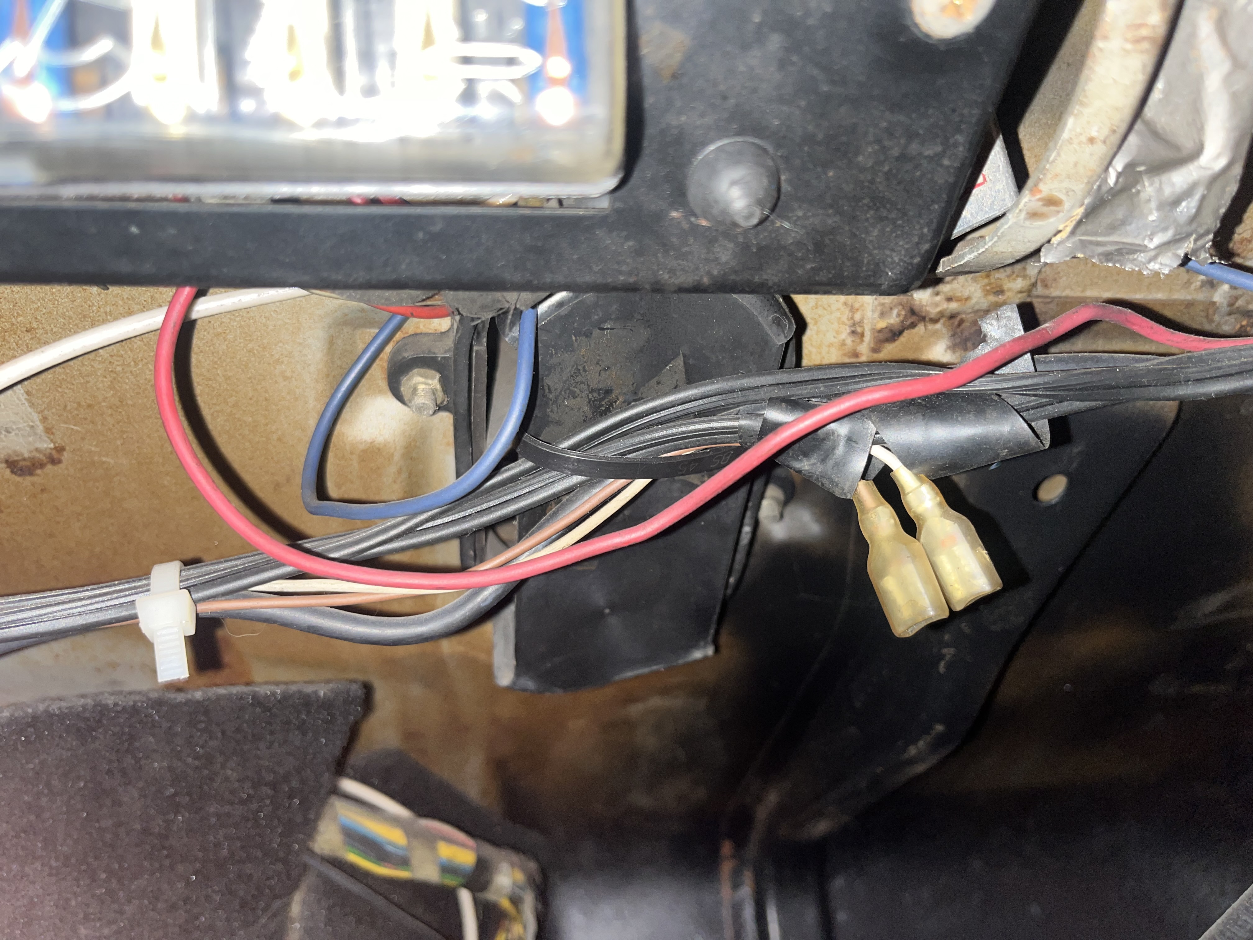

It's me again. A couple weeks ago the World helped me with proper bleeding of my daughter Lilly's car. Now I am trying to get the brake warning light to work before the WCR. It has never worked in the past nine years, flashing or solid.
I am not good with electrical issues. I know how to check my battery with a freebie Harbor Freight dmm, but that's about it. So here are the details.....New 17mm ATE master. Brown with yellow stripe wire connected to the new master. I have pushed the reset button. Brakes are properly bled and there are no leaks.
The turn signals work properly. The flasher works. The seat belt warning light has never worked for 9 years. i checked that the bulb is good for the warning light. All the terminals at the bulb base are connected. I think there are 3 spade connections.
I didn't see a fuse listed for the switch. Someone in a previous post mentioned a diode near the warning light. I'm hoping there is an easy fix for this problem or I will have to take it to an auto electrician. The warning light doesn't work for the e-brake as wall.
Thanks in advance for any assistance. Sean

914xr75   No brake warning light solid or flashing in 1973--help please   Jun 10 2025, 05:55 PM
infraredcalvin   Do you have a brake light switch at the base of yo...   Jun 10 2025, 06:41 PM
cgnj   Brake lights or brake warning light? Two different...   Jun 10 2025, 07:16 PM
dtmehall   :agree:   Jun 10 2025, 07:17 PM
914xr75   It's the brake warning light. Sorry about that...   Jun 10 2025, 08:17 PM
Spoke   It's the brake warning light. Sorry about tha...   Jun 13 2025, 04:25 AM
jim_hoyland   I just went through the brake warning light issue ...   Jun 11 2025, 06:02 AM
914xr75   That sounds like good information. I’ll give tha...   Jun 11 2025, 01:00 PM
jim_hoyland   That sounds like good information. I’ll give th...   Jun 11 2025, 06:48 PM
dtmehall   replace it. the part is cheap, and it isn't ve...   Jun 11 2025, 07:01 PM
Puebloswatcop   From the fuse block...Fuse 9 feeds power to the fa...   Jun 11 2025, 07:16 PM
cgnj   914xr75 If your brake warning light is @12'ocl...   Jun 12 2025, 04:18 PM
jim_hoyland   When I removed the eBrake switch there’s was a f...   Jun 13 2025, 07:25 PM
dtmehall   where did that 'gunk' come from. my 73 was...   Jun 13 2025, 08:36 PM
Spoke   where did that 'gunk' come from. my 73 wa...   Jun 14 2025, 06:47 AM
914xr75   Thanks for all the info. I'm getting up early ...   Jun 13 2025, 10:35 PM
914xr75   @jim hoyland [b]@[url=http://www.914world.com/bb...   Jun 15 2025, 06:22 PM
Spoke   I’m starting to think it’s my turn signal swi...   Jun 16 2025, 08:11 AM
914xr75   RE: No brake warning light solid or flashing in 1973--help please   Jun 15 2025, 06:24 PM
jim_hoyland   Oops   Jun 15 2025, 06:42 PM
jim_hoyland   “Put a 9volt battery to the bulb and it is good....   Jun 15 2025, 06:45 PM
914xr75   [b]@[url=http://www.914world.com/bbs2/index.php?s...   Jun 15 2025, 07:10 PM
cgnj   @914xr75 I corrected my links in my previous post...   Jun 16 2025, 12:18 PM
