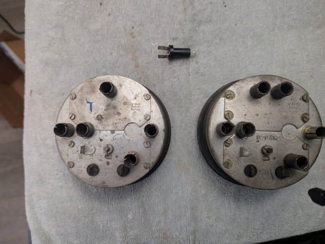

@914xr75 I corrected my links in my previous post. I checked my box of early combo gauges. I had two different types. I attached a pic that also shows a bulb holder. What color wires are on the bulb holder? You should have brown with yellow tracer and Black with Green and white tracer. If that is not the case, what are they?
