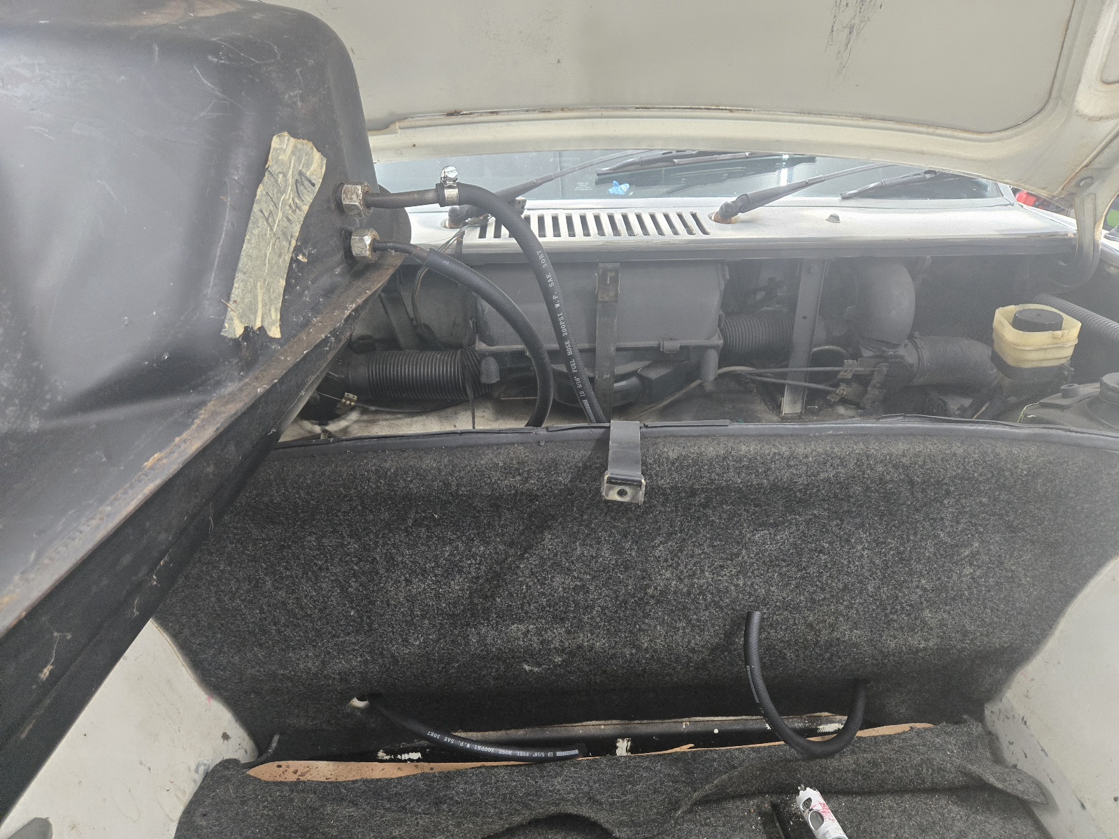

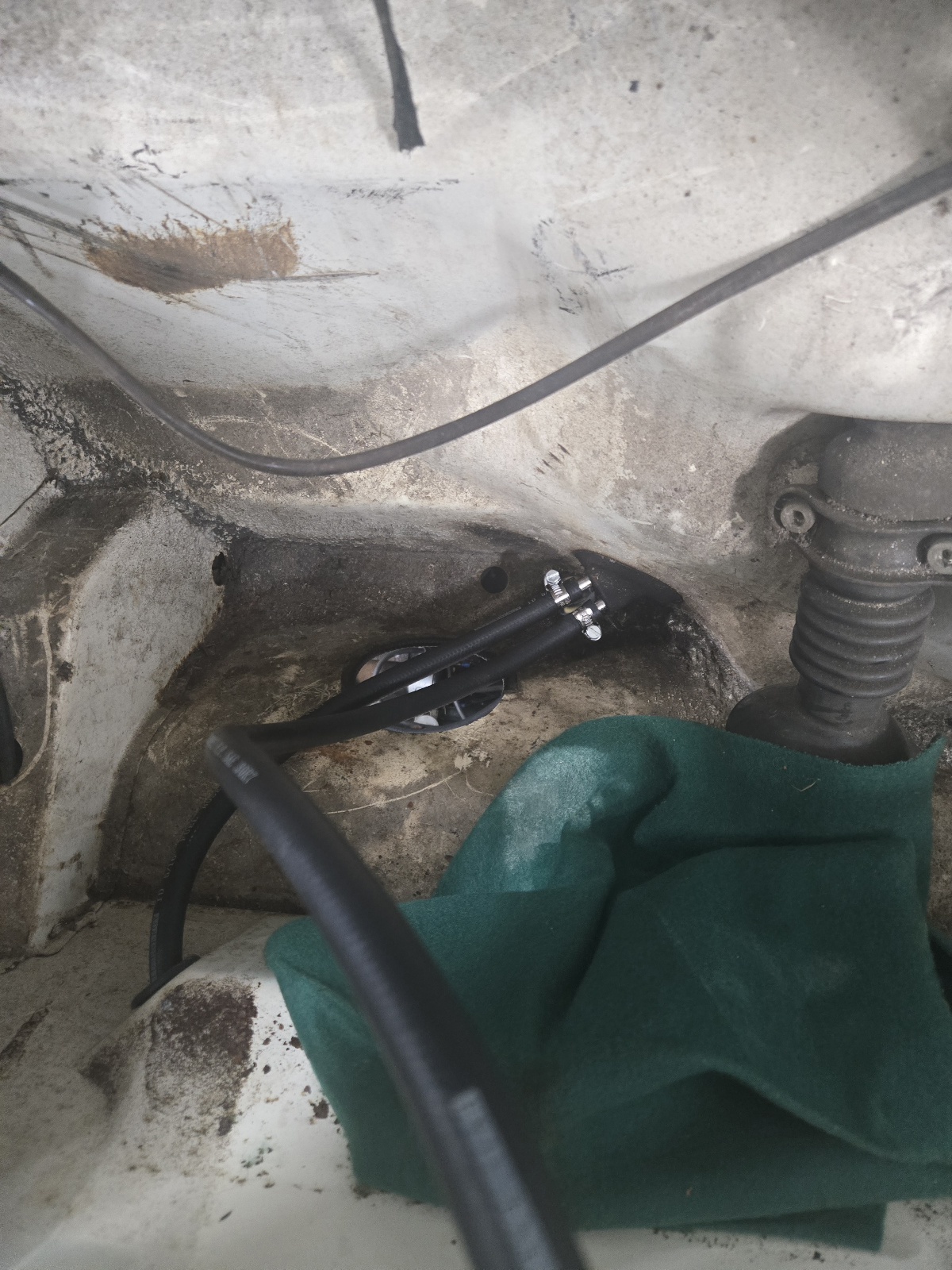

After a weekend at the lake it was back to work, when I have free time LOL. I envy the retired guys. Wish I had more time to devote to hobbies. Anyway, tank is pretty much fully in. Trimmed a little on the lower oil return. Next, I was putting off installing the return fuel line. The TO line was already done, but since it was carbs, who needs a return. CIS needs a return. Went in without too much trouble. Not sure why I was sweating it (IMG:style_emoticons/default/biggrin.gif) . I had to remove the tank for ease of install as well as setup the return line. I decided to mimic my other conversion as well as others and install the FP right in the frunk, easily accessible. I plan to run a pre filter to the Bosch 044. The CIS has a filter already, but this will help keep the pump clean. Listen, you might be thinking, Nick you're using those worm gear clamps, thats a big no-no. Well, these are worm gears band clamps so no need to worry about the metal cutting into the rubber fuel line. I'll be honest, these clamp down tighter than actual fuel injector clamps. Maybe I have only bought cheap ones, but the torquing force that I want seems to strip the tiny machine screw. I also milled (poorly i might add) the turbo valve cover. This is so you can check the valves/remove the cover with the engine in situ. Pretty sure only the driver side needs to be done. |
