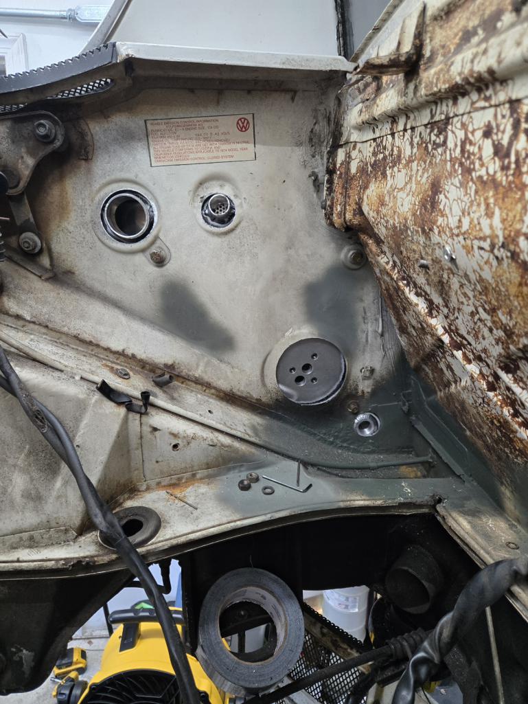

And just like that the tank is 90% in. I need to trim a little on the return line hole. My template must have been slightly off. Went a lot smoother this time than my 1st conversion.

QUOTE(nditiz1 @ Jun 12 2025, 06:37 AM) *
Have you considered sealing of those fitting tank to body ,I couldn't find them so used quality closed cell foam to seal them ,the console seal is available from URO ,mine fitted well .
Keep up the good work you a powering ahead ,cheers.
