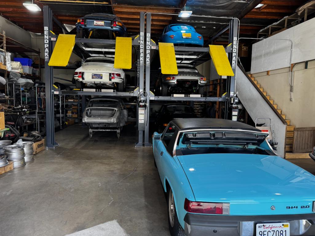

Side note - Scott has a beautiful 73 2.0 914 in Olympic Blue...just like mine in the midwest! It's a great shop.
