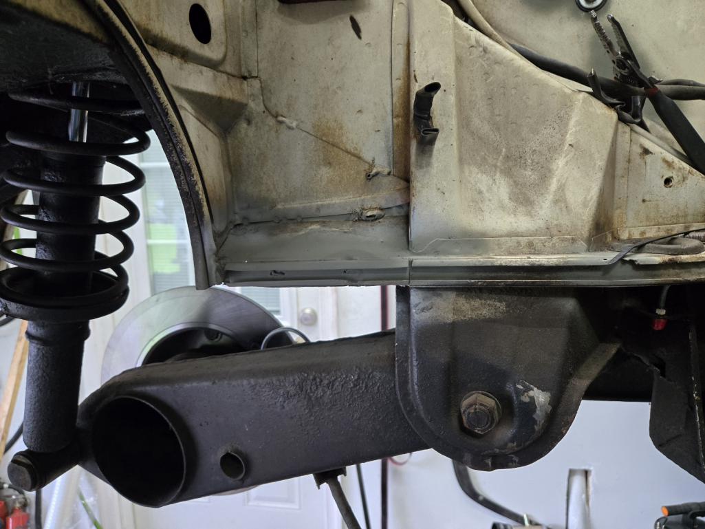

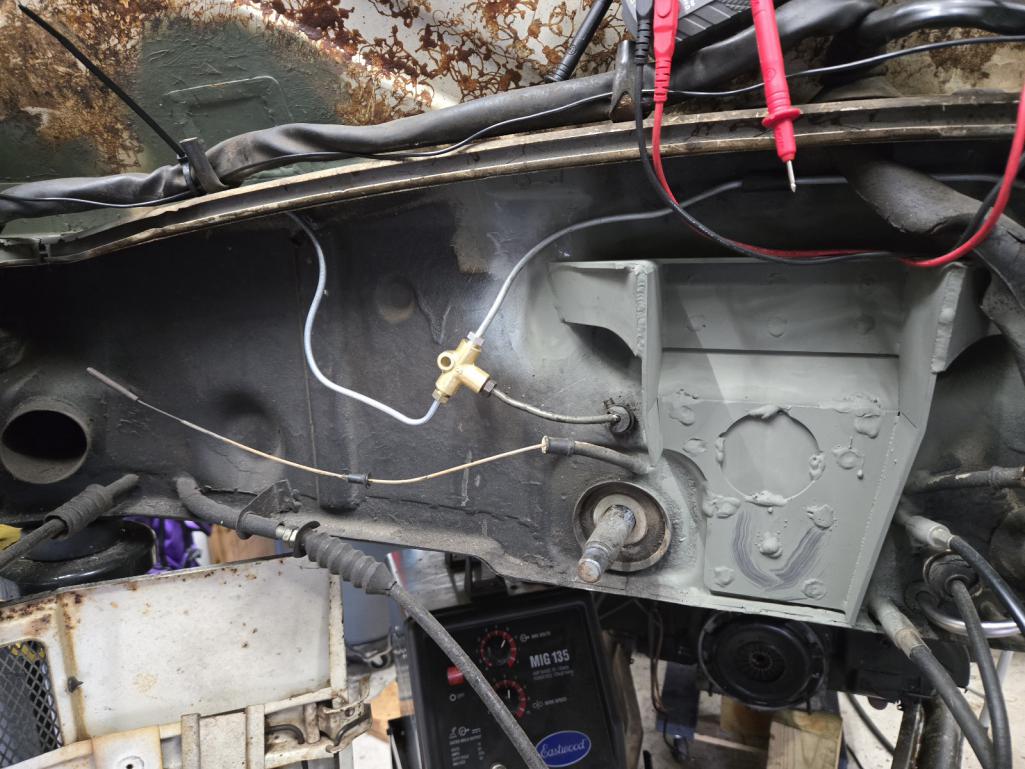

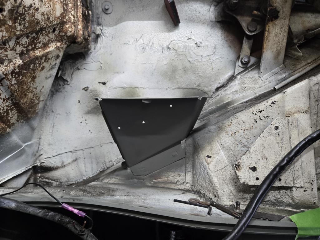

Been steadily working on little things: I finished the wiring harness from the factory harness to the SC harness. Running 10 wires total. Utilizing a keyed hot for the CIS and the heater green/white wire for the oil temp. I'm not running heat so I will hook into the wire going to the lever. Ran new brake lines for the rear. The ones in place were in decent shape, but i needed to move things closer to the driver side. I used a basic T from a beetle. Not pretty, but functional. New rubber lines as well. Decided to bust out the welder, hopefully for the last time. The seal channel on the driver side was rusting away. I had leftover from restoration design. New engine seals are also installed. I also welded in the battery tray. My car was already modded to the trunk. I'm not really a fan so im moving it back. I'm going to screw down the top plate. Lastly, I worked on the engine. Didn't realize the 6 mount does not clear an AC pulley. Luckily I had a spare from a 2.7 or early SC. I finished checking the valves and cleaning the cam towers for new gaskets. The next major item will be to address the oil cooler. Do I want to keep it in the rear OR run it to the front. |
