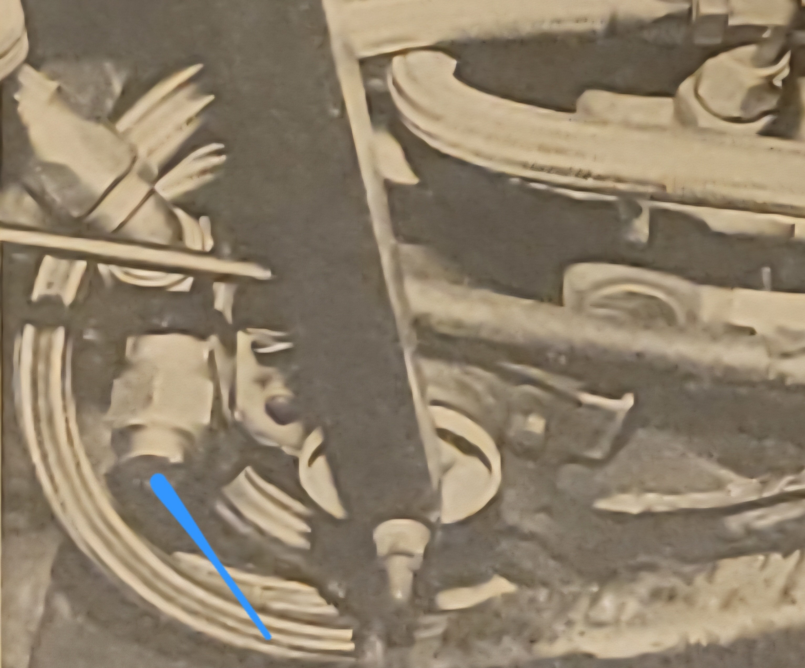

Maltese Falcon
post Jun 30 2025, 10:31 PM
Posts: 5,345
Joined: 14-September 04
From: Mulholland SoCal
Member No.: 2,755
AN#16 line with AN#16 tee/ safety wire. The remainder of the oil lines: T-Statt, Fr. cooler, are AN#12. B+W pic out of '80's "VW + Porsche" article.
