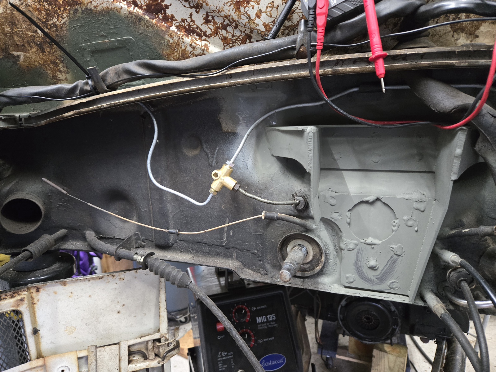

Ran new brake lines for the rear. The ones in place were in decent shape, but i needed to move things closer to the driver side. I used a basic T from a beetle. Not pretty, but functional. New rubber lines as well.

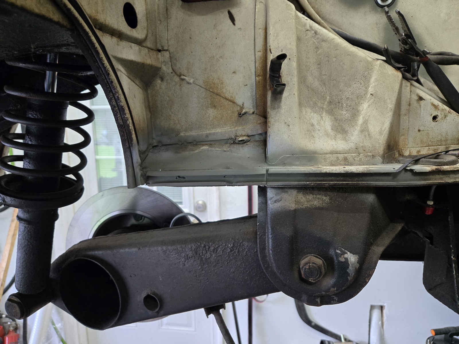

Decided to bust out the welder, hopefully for the last time. The seal channel on the driver side was rusting away. I had leftover from restoration design. New engine seals are also installed.

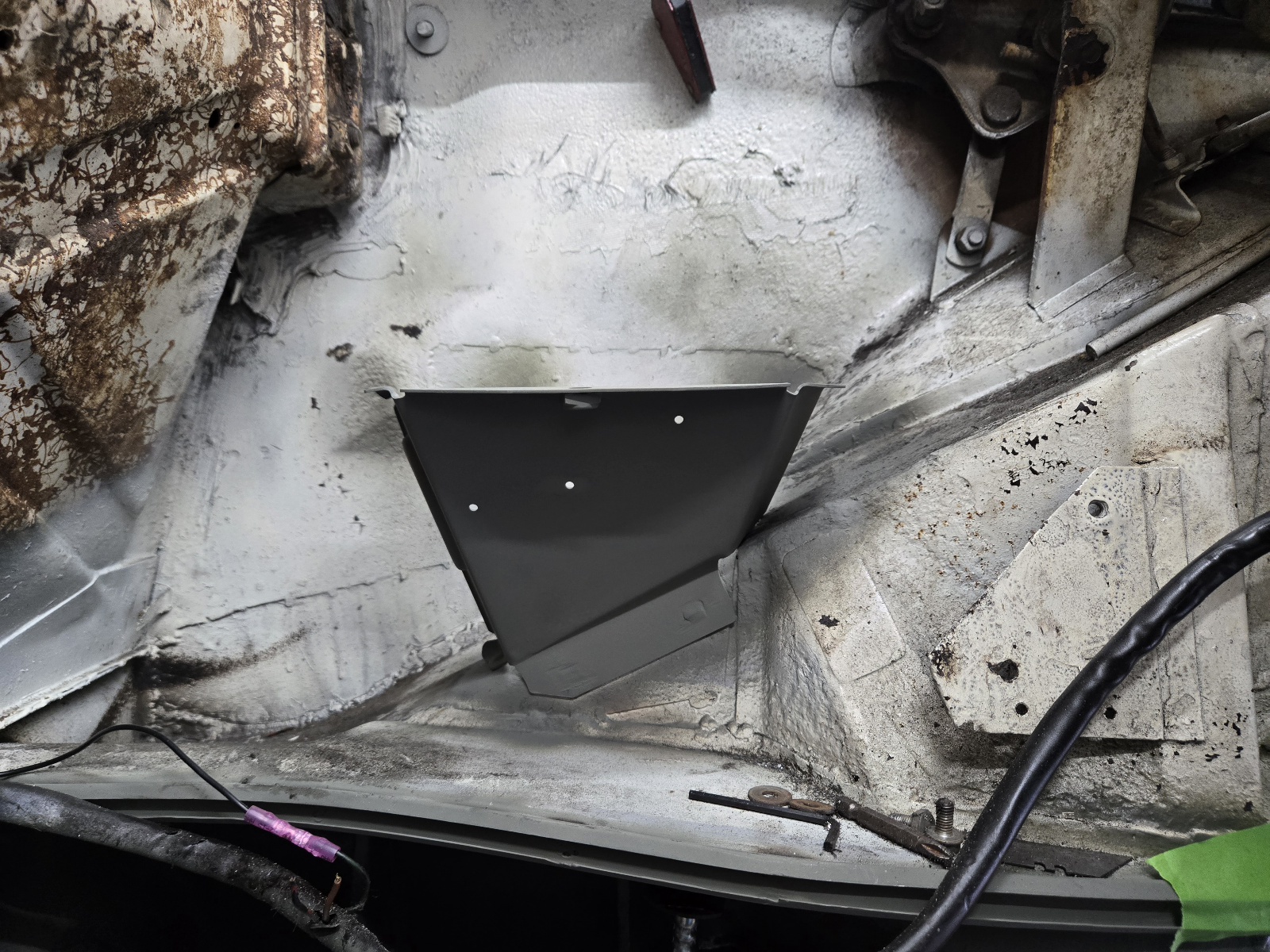

I also welded in the battery tray. My car was already modded to the trunk. I'm not really a fan so im moving it back. I'm going to screw down the top plate.
