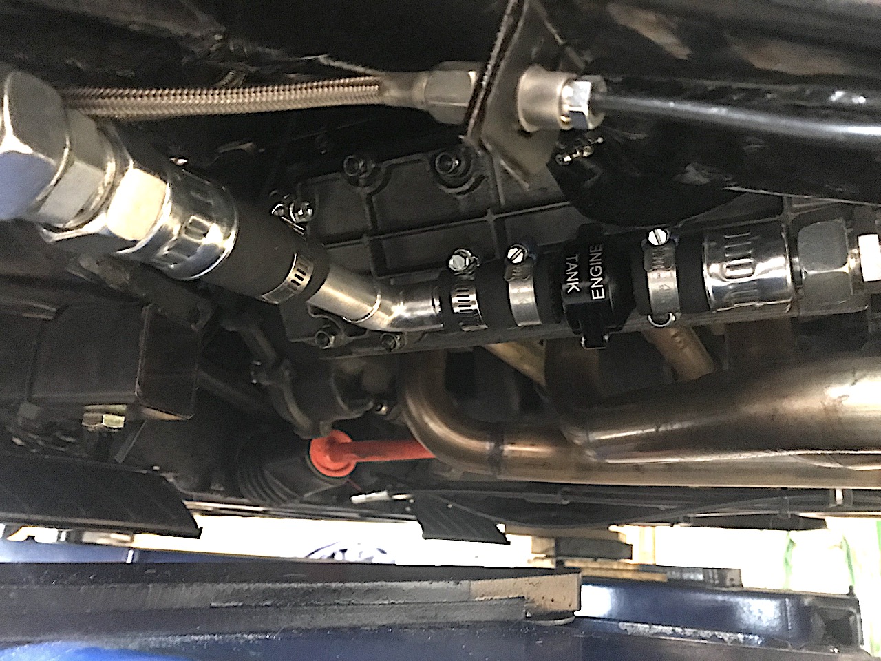

I just open the union on the left, drain and close. Attached Image

QUOTE(mlindner @ Jul 1 2025, 07:29 AM) *
I might go this route, is that 1/2" copper pipe/elbow?

I just bought one of those valves and need to plumb it as well. As to the Copper question, yes I am interested in what metal that is. Copper can work harden with the heat and over time become brittle and fracture.... which would be bad on the feed line...

Installing the Rothsport valve on stock hose can be done, just gets a little tight. The extra 2 hose clamps are to keep the bend from kinking. I replaced the oil line hose with new and there wasn't a preformed 'elbow'
