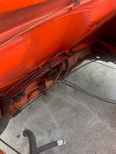

The engine Bay and other parts

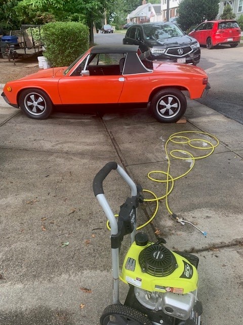

I was able to get a smaller power-spray handle so I could get into the engine bay with the spray handle.

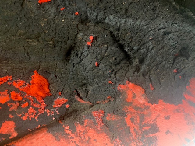

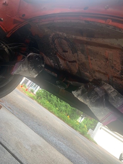

I am trying to understand if this car was coated by 'Zeibart' or similar, some of the crud in the engine bay was grease and grime, however, on the underside and wheel wells, there is a very tough material that seems like oil and gravel, however, it comes off in sheets in some places and will not come off in others.
Does anyone else have experience with this type of undercoating?
Also, this is as clean as I am going to get the engine bay - will wax/buff it next

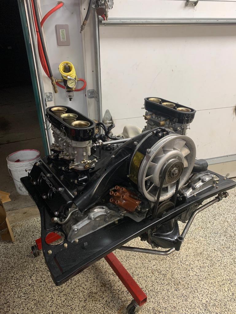

Here is the engine ready to go into the engine bay

Cairo94507   That may be undercoating applied when new. Mine h...   Jul 7 2025, 12:51 PM
