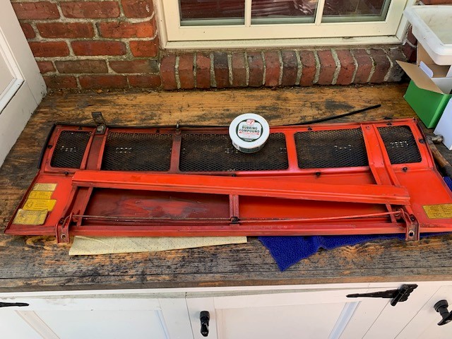

Cleaning the underside of the lid, dang the old oil is like glue - turns out that this rubbing compound works really well, cuts through the grease,
HALF WAY DONE (IMG:style_emoticons/default/dry.gif)
