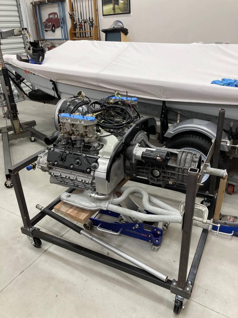

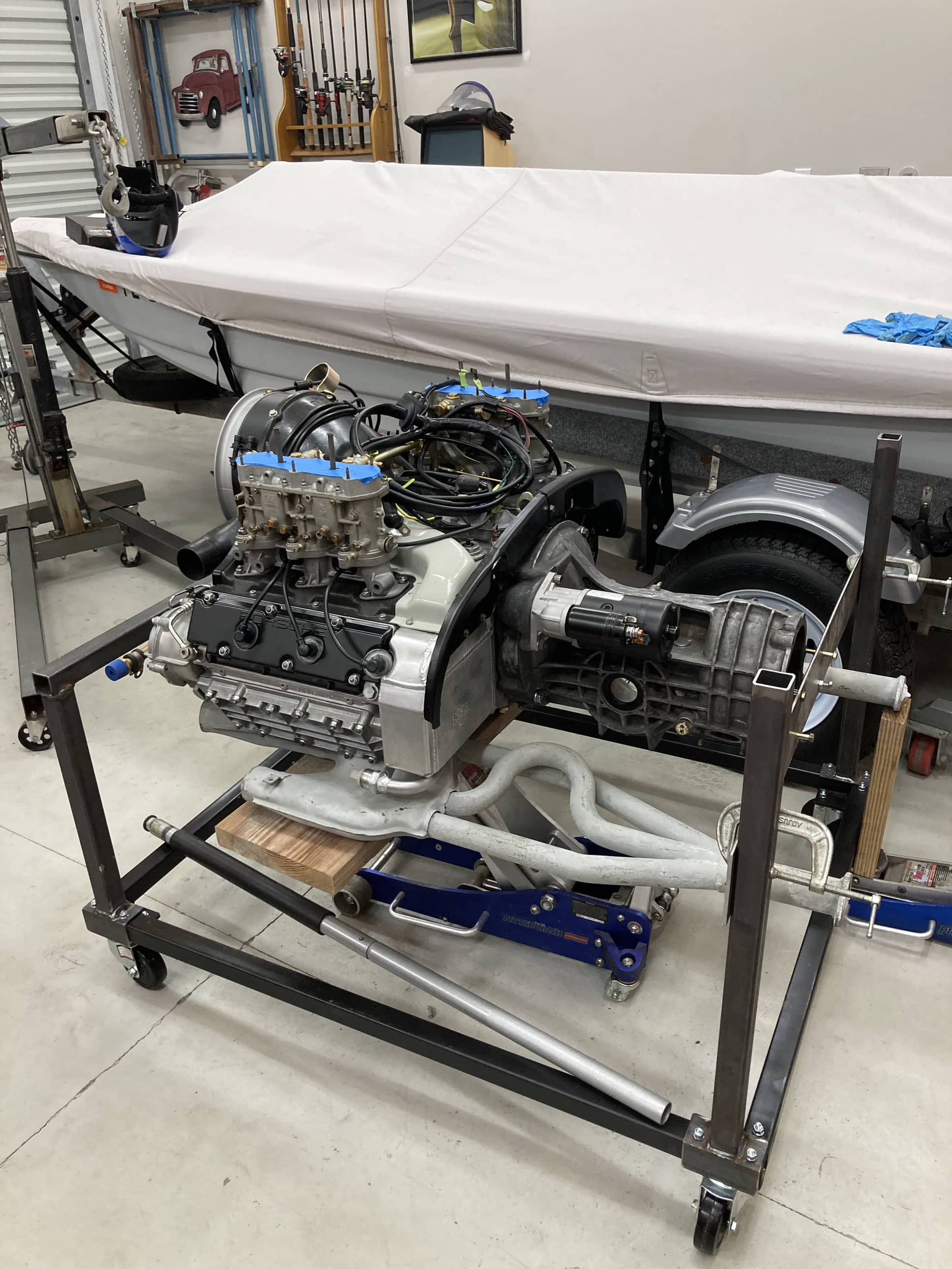

post Jul 17 2025, 04:18 PM
Posts: 1,076
Joined: 22-January 09
From: Panama City Beach, FL
Member No.: 9,961
Engine run stand under construction…..any suggestions appreciated.

sixaddict   Engine run stand under construction…..any sugges...   Jul 17 2025, 04:18 PM
sixaddict   Engine run stand progress…..now need oil lines. ...   Jul 29 2025, 07:16 AM
rgalla9146   Engine run stand progress…..now need oil lines....   Jul 30 2025, 04:53 AM
sixaddict   Long story but you are correct. ….unfortunately ...   Sep 12 2025, 04:17 PM
Montreal914   Great work, love the installation of the lower inn...   Jul 29 2025, 08:45 AM
sixaddict   Initial start up…..like Christmas morning. Had...   Sep 12 2025, 04:31 PM
