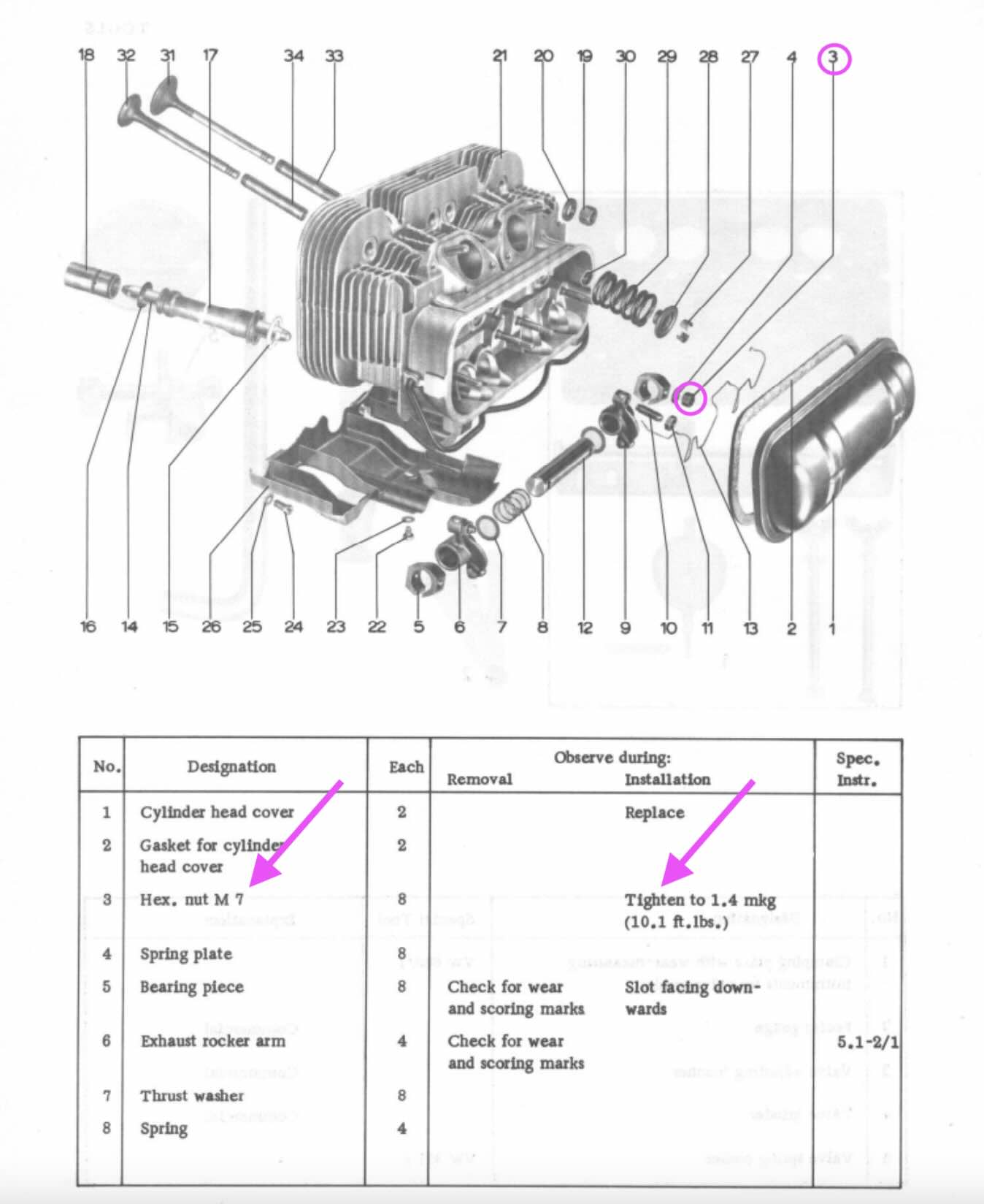

@Dave_Darling
Is 11 lb-ft the torque wrench setting for the nuts that hold on the rocker arms?
What about the nut on the adjuster screws?

I'm diving in on the push rods.
Hoping someone can share the torque LB for the rocker arm nuts nor the adjuster screw nuts. I cannot find anything in the Haynes manual.

QUOTE(DC_neun_vierzehn @ Jul 18 2025, 02:45 PM) *
I'm not much help; mine are "just that much" tight... GA

I kept digging and think I finally found the answer in the Shop Manuals online:
http://p914-6info.net/PDFs/Group%201%20Engine%20914-4.pdf

DC_neun_vierzehn   Hoping someone can help - which # is the correct p...   Aug 8 2025, 10:55 AM
emerygt350   Wish I knew... Maybe check autoatlanta and see wh...   Aug 8 2025, 10:58 AM
Jack Standz   Do you have 8mm or 10mm adjusters? Personally, w...   Aug 8 2025, 03:08 PM
DC_neun_vierzehn   Do you have 8mm or 10mm adjusters? Personally, ...   Aug 8 2025, 06:02 PM
Dave_Darling   039 part numbers are for 2.0 engines, almost unive...   Aug 8 2025, 05:56 PM
DC_neun_vierzehn   039 part numbers are for 2.0 engines, almost univ...   Aug 8 2025, 06:05 PM
