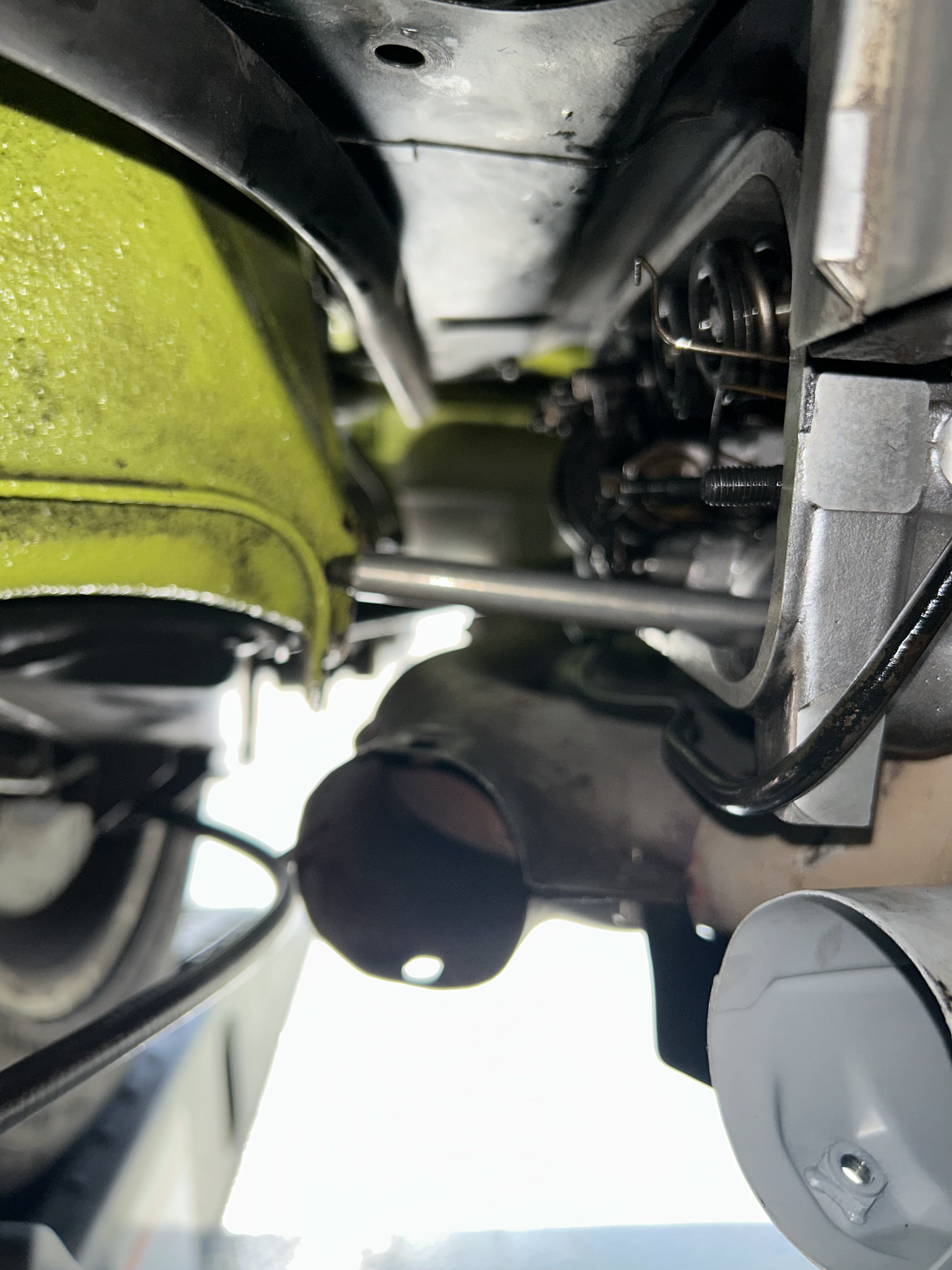

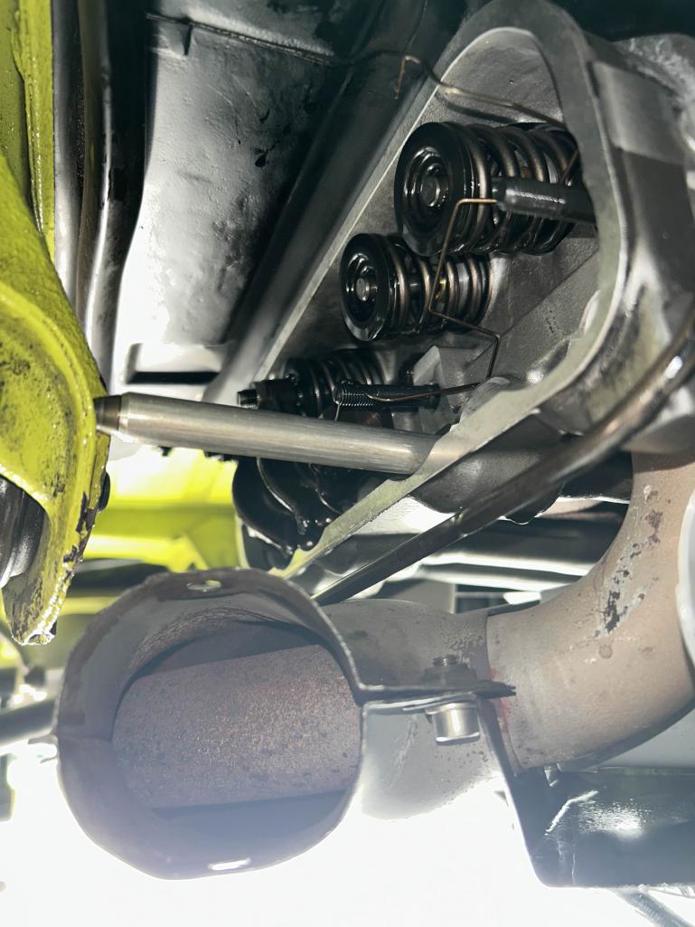

So I wasn't crazy when I posted earlier that I cannot get the intake push rod out on cylinder 4. It's hitting the body/frame of the car. Should this not be happening? Any way to pull it out so I can roll it w/o without dropping the engine?

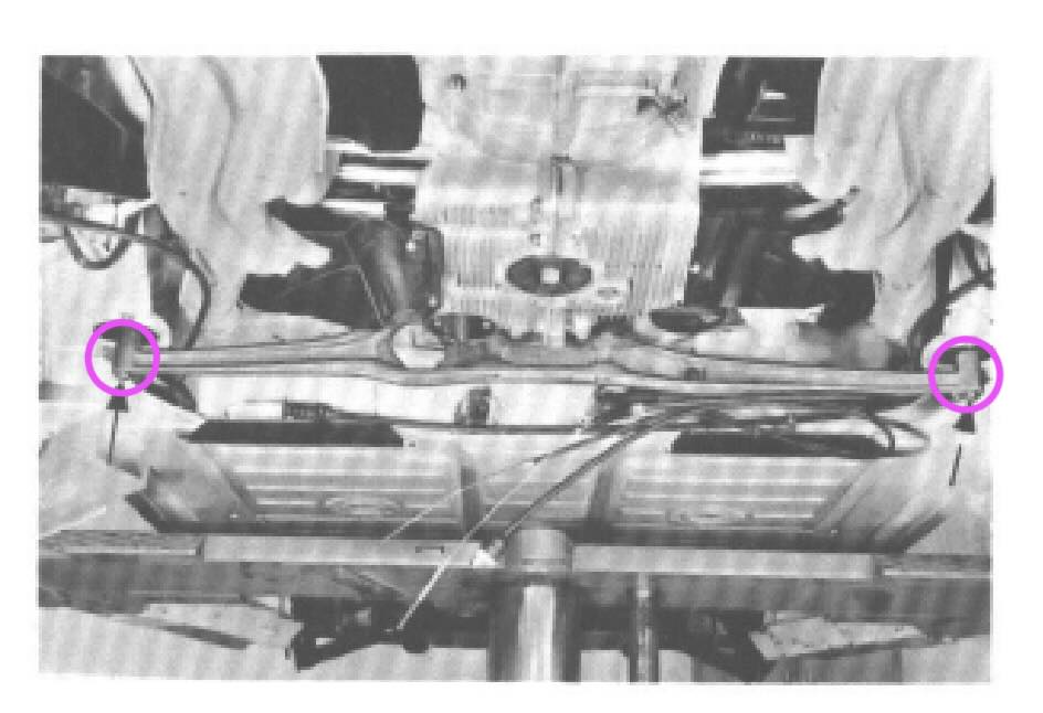

You don’t need much. Undo the two large bolts on the crossbar. And lower it a bit with a floor jack.
Ok. Never done this before. You're talking about the bolts at each end of the bar, correct? Also ... what's the torque on those when I reinstall them (the shop manuals online do not include that)?

Yes, Seems like it was 23 ft.lbs, but my memory has been suspect the past year.
