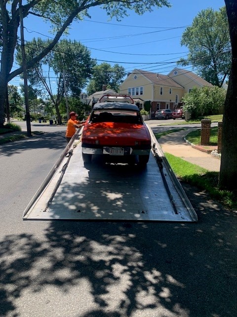

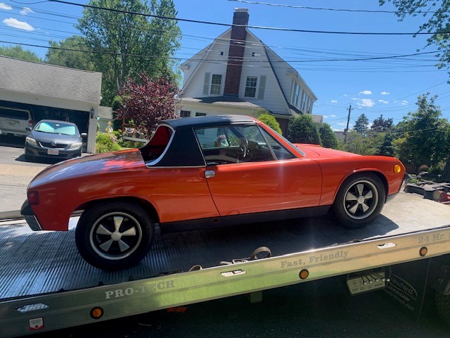

ctc911ctc   Back from the ICE house, good kid, hard working - ...   Aug 11 2025, 07:07 PM
ctc911ctc   On its way home through Boston Traffic...   Aug 11 2025, 07:10 PM
