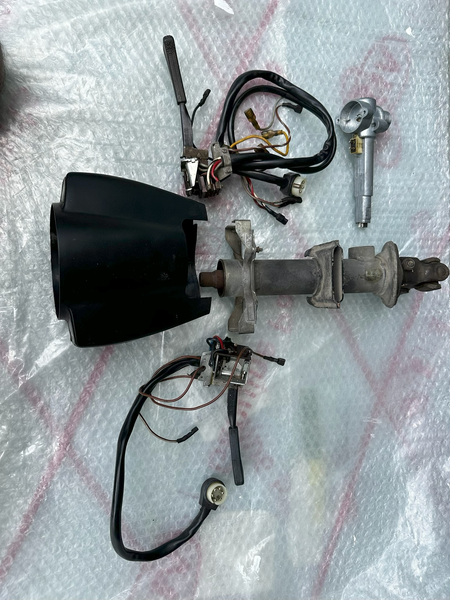

Just to prove (to myself) that progress continues on this little project, I sourced a complete 71 911 steering column to convert the 914 to early factory left hand ignition. While the 72 six did have it on the column, it's just so much cooler to have it on the left! I think the conversion will be well worth it.
Shout out to Bob A that responded to my wtb ad over at Pelican.
I also picked up the dash conversion piece from Sierra Madre. With a discount code of 10% off I was able to get it $25 dollars cheaper than PMB who wanted 35 dollars to ship! Out the door was $50 vs PMB $75. :-/ Still better than Auto atlanta who has the most confusing web site of all time. I couldn't even find the part there and gave up after a few minutes. Restoration Design makes the part of course, but they calculate shipping after you pay, so who knows what Canada to Vegas would cost.
Should be a fun project to test my fabrication skills as there's quite a bit finagling on getting the column to work right.
