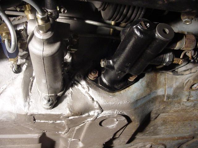

Had lots of requests for pictures of the hydraulic clutch conversion, so here you go.
Things that have changed since the last episode: 1) re-did the slave mount. Got rid of the stupid pulley bracket and did it right. 2) MC install was a major PITA. Had to cut a chunk out of the pan and make a mounting surface that was flat and angled in the right direction. 3) I found that there is not enough room up next to the steering rack to cut a line and re-flare it after you have discovered that you slipped the flare-nut on backwards before plumbing all the lines (ARRRRGGG!!!!). That's ok, I did a better job the second time anyway. 4) Rebuilt pedal box while I was in there (Had the bronze bushing kit laying around). Thanks Lawrenece for your comments about this last week. I almost skipped it and saved it for another time. Glad I rebuilt it. Big difference. Ok, here's the pics. (No pic from inside the car 'cuz you can't see anything with the pedal box in the way) -Ben M. Attached image(s)

I have bees in my epiglotis ![]() ![]() ![]() ![]() Group: Members Posts: 2,196 Joined: 7-February 03 From: Kennewick Man (E. WA State) Member No.: 266 |
Closer shot of the clutch MC next to the brake MC.

airsix Parts details:
Tilton 7/8" aluminum master cyl. ... Jun 4 2003, 02:30 AM

airsix To answer some questions:
Feel: Yes, I like the ... Jun 4 2003, 10:43 AM
