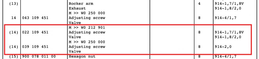

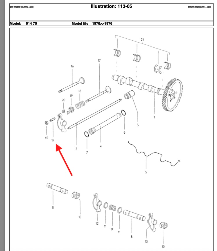

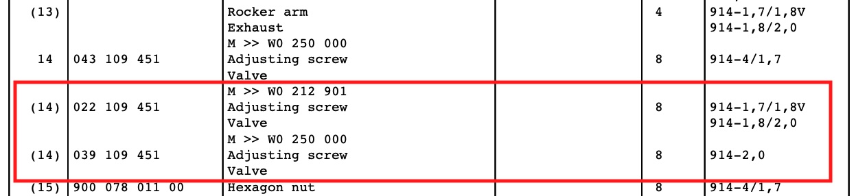

Hoping someone can help - which # is the correct part # for adjuster screws ('73 2.0): is it 022-109-451 or 039 109 451 (or will either work)?
I'm able to buy 022 directly from Porsche, but 043 does not come up. Thus, hoping the 022 part will work.

DC_neun_vierzehn   Hoping someone can help - which # is the correct p...   Aug 8 2025, 10:55 AM
emerygt350   Wish I knew... Maybe check autoatlanta and see wh...   Aug 8 2025, 10:58 AM
Jack Standz   Do you have 8mm or 10mm adjusters? Personally, w...   Aug 8 2025, 03:08 PM
DC_neun_vierzehn   Do you have 8mm or 10mm adjusters? Personally, ...   Aug 8 2025, 06:02 PM
Dave_Darling   039 part numbers are for 2.0 engines, almost unive...   Aug 8 2025, 05:56 PM
DC_neun_vierzehn   039 part numbers are for 2.0 engines, almost univ...   Aug 8 2025, 06:05 PM
