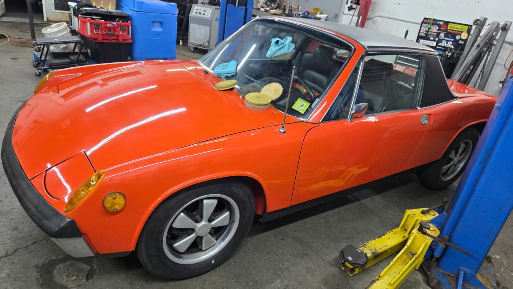

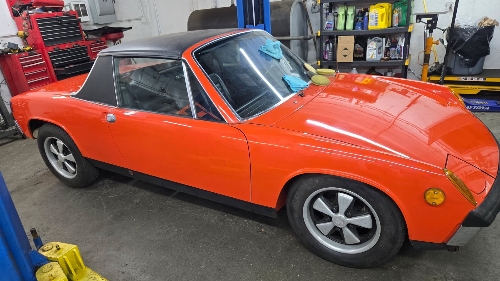

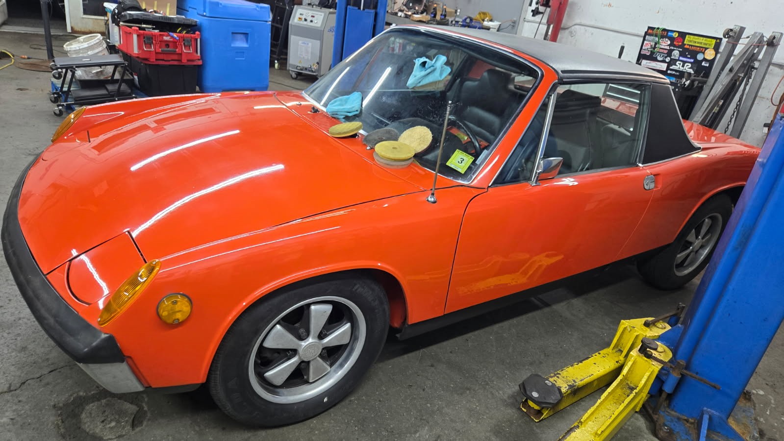

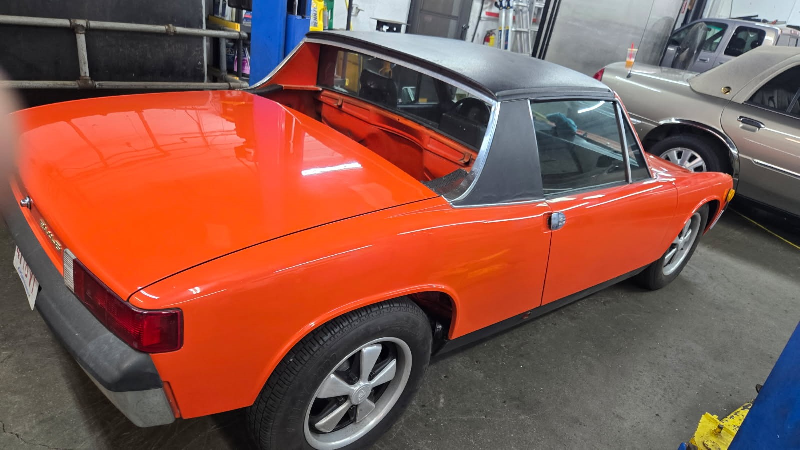

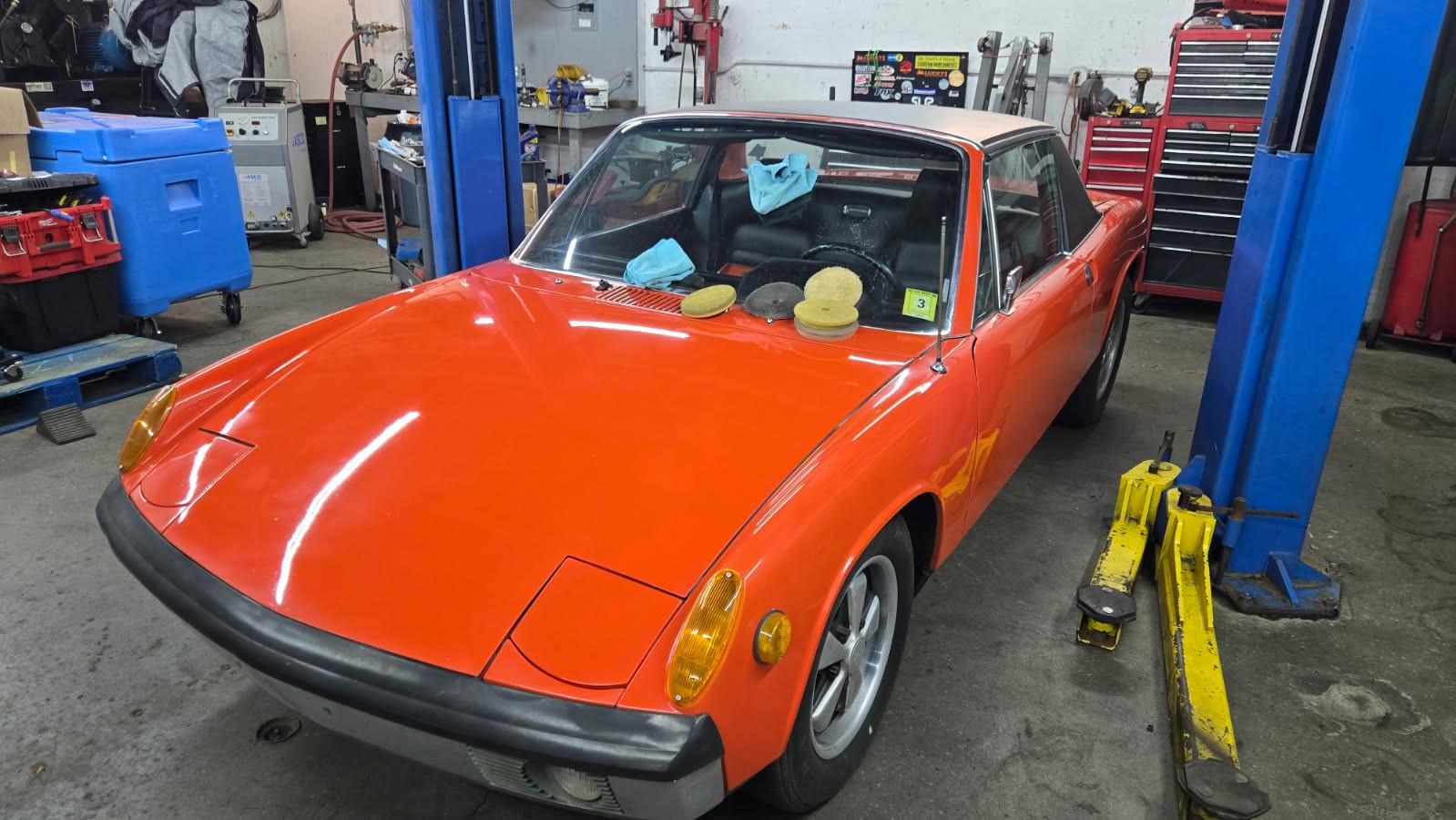

I am in the midst of removing the engine and transmission. All original. There is oil everywhere, not flowing but seeping - seems that the valve covers are not tightened or have loosened with age. Here are the first pics:
On the rack - hopefully not for long:
