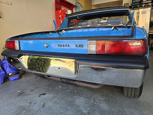

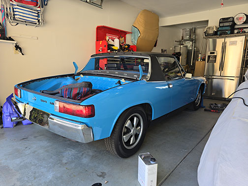

Here is how the car looked back in 2019 when it first sold on BAT:
Kind of interesting to see how it changed over the years.

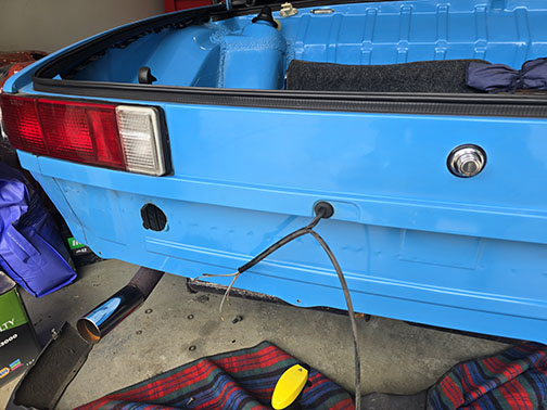

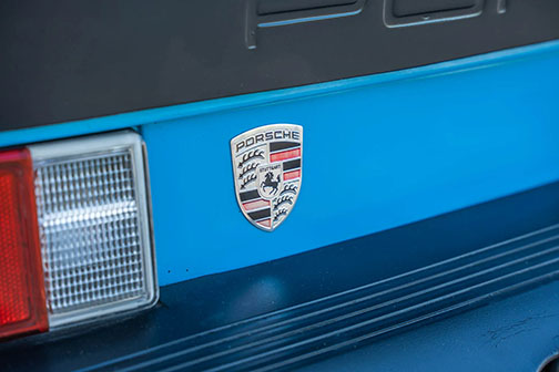

Trunk Panel:
While waiting for the package I decided to remove the old/faded Porsche crest of the rear trunk panel. Thankfully it was just a sticker, so no holes to fill in.
Removed with some fishing line and some elbow grease:

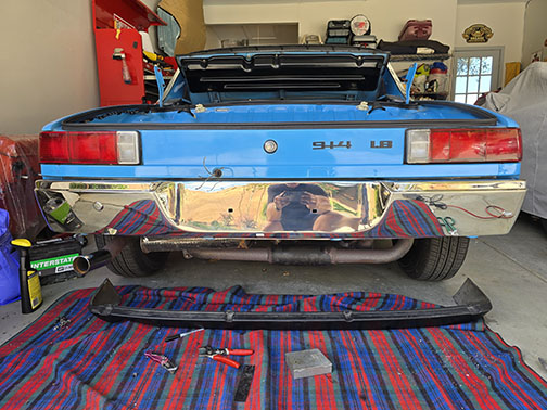

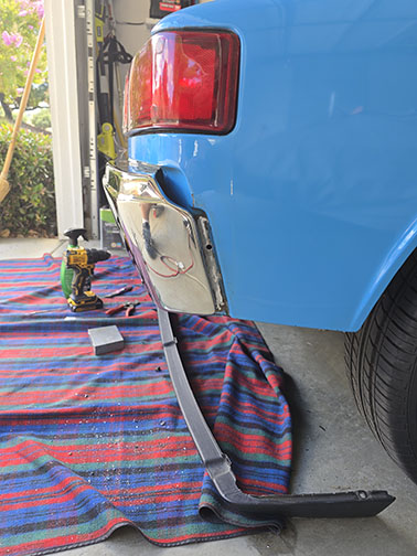

Rear Bumper:
BUB removed and tabs ground off. Ooops... blew through the panel there. Need to lower the bumper a bit maybe.
More eyeballing:
Few different angles:

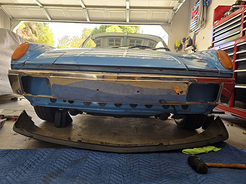

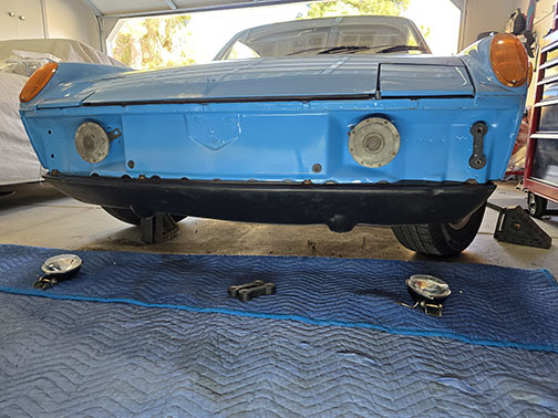

Front Bumper:
Didn't take too many photos of the spot weld removal and the grinding down on the front lip. BUB Removed and new bumper offered up for some eyeballin

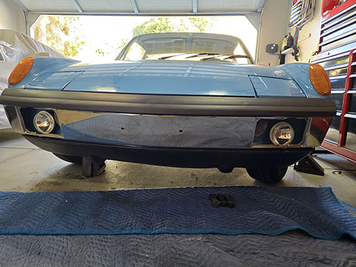

Horns installed after I filled the holes from the BUB bumper mounts:
Need to tweak it a bit more, also waiting for the rivnut tool to arrive so I can mount the driving lights. Maybe I'll get the correct driving light grills this week:
