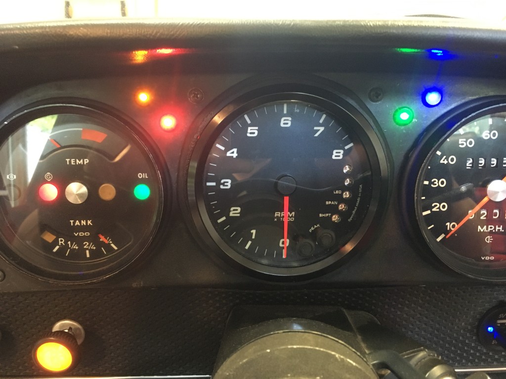

https://speedhut.com/gauge-applications/rev...pm-shift-light/
3D printed a thin 1/4" wider plastic washer to put between the tach and the stock rubber grommet to capture it to the correct size so it would not fall in.
I'll 2nd that! Good people and they'll work with you.
