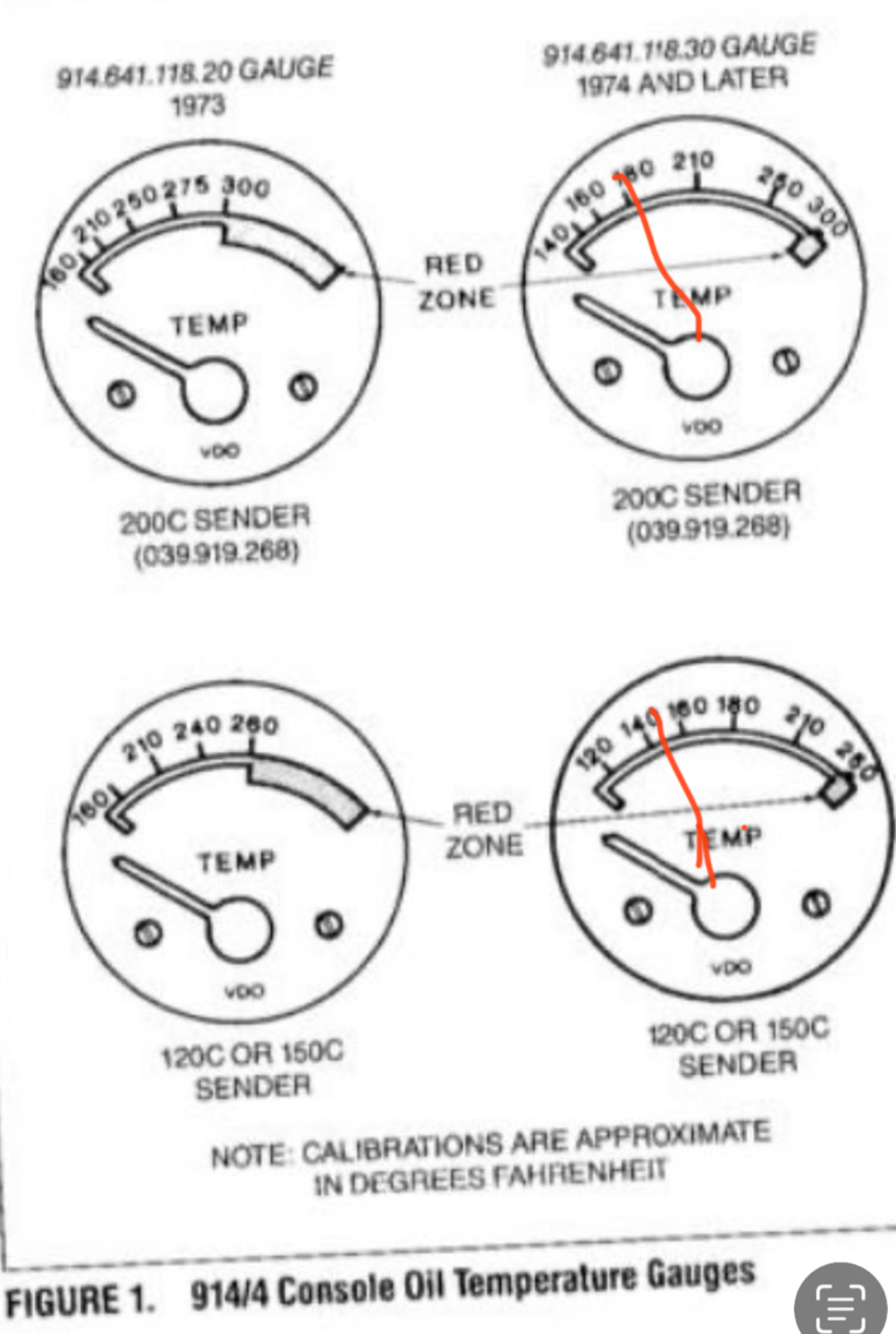

QUOTE(Ron914 @ Aug 19 2025, 07:03 PM) *
I will try your suggestions later today and post the results . You can see my factory oil temp gauge in the photo of the vacuum and Dakota CHT , its has only moved a little bit , don't know if the 90F corresponds with the reading shown . I have an IR thermometer so I will also take a photo of my readings with it and the Dakota and factory temperature gauge.
Thanks
Yeah that doesn’t look right either
Is your Dakota gauge reading Celsius rather than Fahrenheit?
Oil temperature lags head temperature - by a significant time.
Although your oil temp gauge isn’t hot by any stretch - I’m surprised it’s even off the peg if cylinder head is 90F. Just eye balling the red line would suggest your oil is running hotter than the heads if this is a single warm up cycle that wouldn’t be possible. Heads cool faster than oil once the oil and case are hot so without knowing exactly what the conditions were I’ll just say that’s odd for oil temp to be hotter than head temps.
