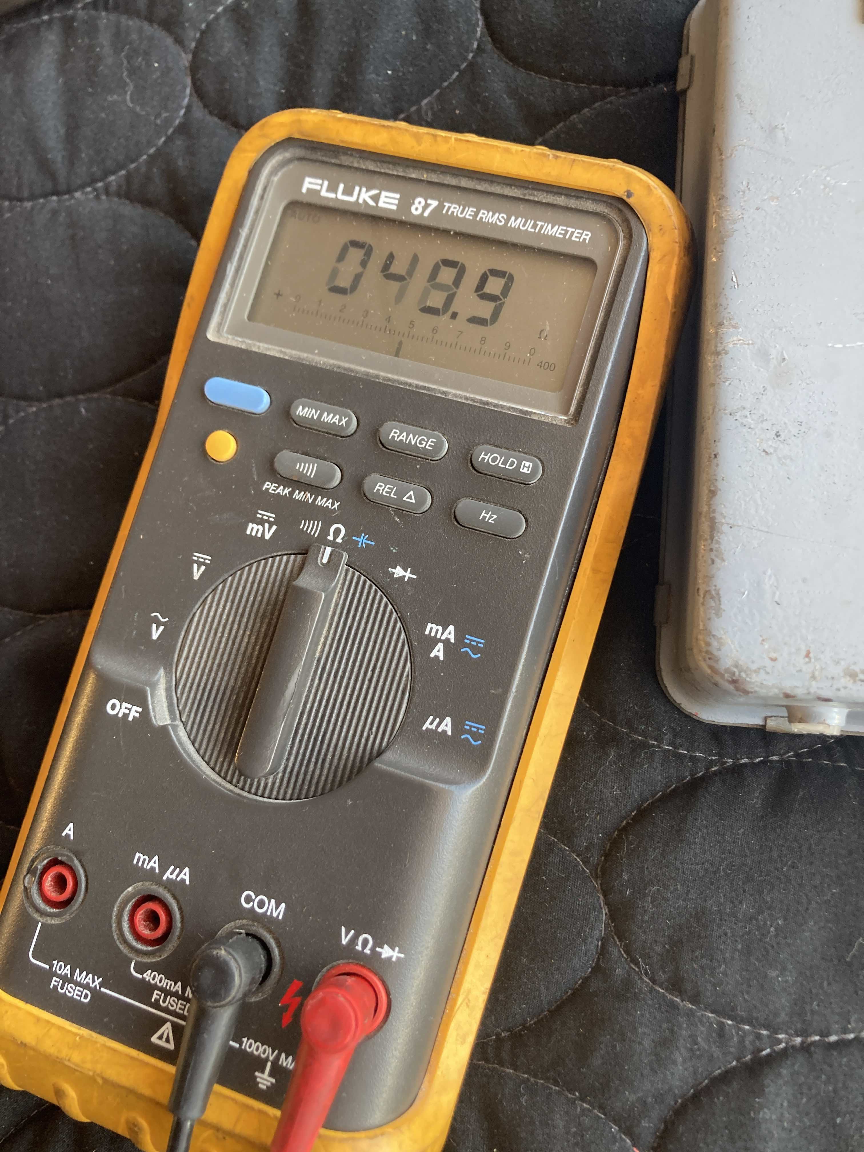

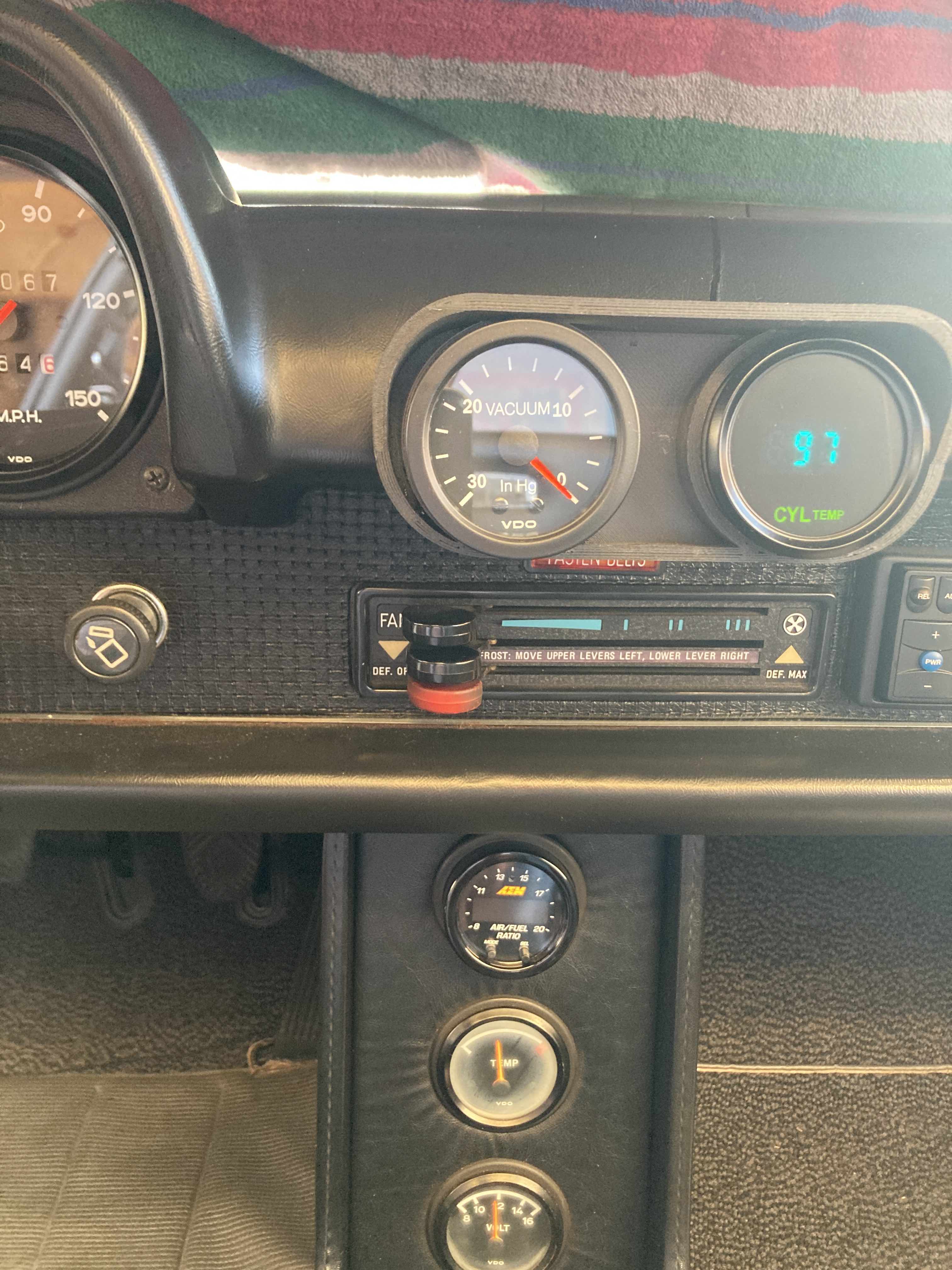

@Superhawk996 I made the checks you requested and I have to say after reading your last comments I also questioned the accuracy of the Dakota CHT gauge . When I purchased my gauge I mistakenly ordered it with a 1/2" ring terminal (12.7mm) because I didn't want to order a 18' connecting wire from sensor to gauge ,what I didn't know was because I ordered the shorter connecting wire they swap the 14mm ring for a 1/2" ring with the shorter wire . You only get a 18' connecting wire with the 14mm sensor ring . I contacted Dakota Digital and asked if I opened the ring terminal up to 14mm or 0.551181" and was told as long as I don't cut the wire it should be ok .
Measured value of CHT sensor @ ECU plug :car cold ,garage temperature ~80F ,measured value 3.293k ohms
I checked my meter against the 270 ohm resistor I bought from Auto Atlanta and it measured 266.2 ohms .
Started my engine AAR was open / idle~1400
The car started running bad @ ~9:20 minutes idle was hunting up to 1200 , something seems not right .
After ~15 minutes engine stops , unplugged the CHT and engine just cranked and would not start , car smells flooded , my Dakota gauge reads 97F, the CHT sensor measured 048.9 ohms @ the ECU plug, my IR reads 143F .
My IR thermometer read 98F when checking it against the Dakota @ 93F .
I took photos but am only adding the TS2/CHT value read @ the ECU plug between terminals 23 and ground and my gauges when engine stopped .
I did get a chance to check the CHT sensor I purchased from 914 Rubber I dropped it into a cup of 212F water and the resistance read 0.497 k ohms on my meter. I checked the value of this sensor @ room temperature and it read 1.917 k ohms .
