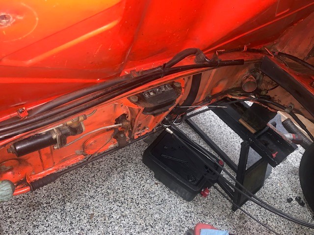

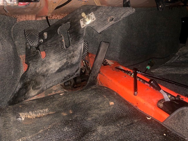

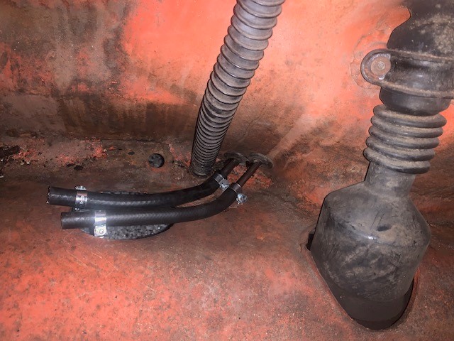

********FUEL LINES***********
Took out the Tank - yea, I filled it a week or two prior to starting this adventure (IMG:style_emoticons/default/dry.gif)
It had been out prior, but the lines we still original, not in bad shape but I want to assure that I have a low probability of fuel leaks - added the Stainless lines from Tangerine - Thank you Chris
My daughter - the only one home - crawled under the car ( said "ew" perhaps 10 times) and pushed on the lines. I was under the dash with the peddle board sticking into me while guiding the lines through the grommet at the front bulkhead. Seems like it went in OK.
Pretty certain that the lines wrapped around EVERYTHING, not a straight forward task - however - I will be replacing the Clutch and throttle cable.
Getting Closer!
The breather hoses are $80/meter! YOW!
Also, I took off the skid plate and found that the PO decided to save a little current - not sure what is happening here......will let you know when I do.
