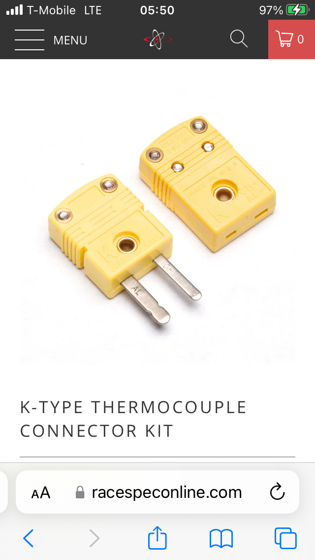

Now this becomes a bit annoying when you need to drop the engine. You can put a proper K-type thermocouple connector inline through (shown below).
At one point, I was even considering having a few bulkhead connectors on a panel in the engine bay so I could connect various thermocouples for temperature measurements (heads, exhaust gas, other…).
