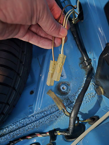

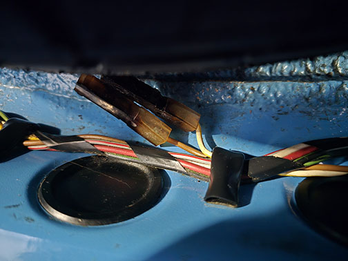

I'm back with more photos and questions!
I am trying to hook up the early model horns and driving lights behind the newly installed early bumpers. I would like to use the wires that are already there, what do/should these wires go to?
We have two sets of white/brown and another clump of wires with multiple colors and nothing connected to them.

Chad911sc   The white/brown should be your driving/fog lights....   Aug 23 2025, 05:12 PM
TRP   Hello Chad! Thanks for the info, much apprecia...   Aug 25 2025, 02:20 PM
