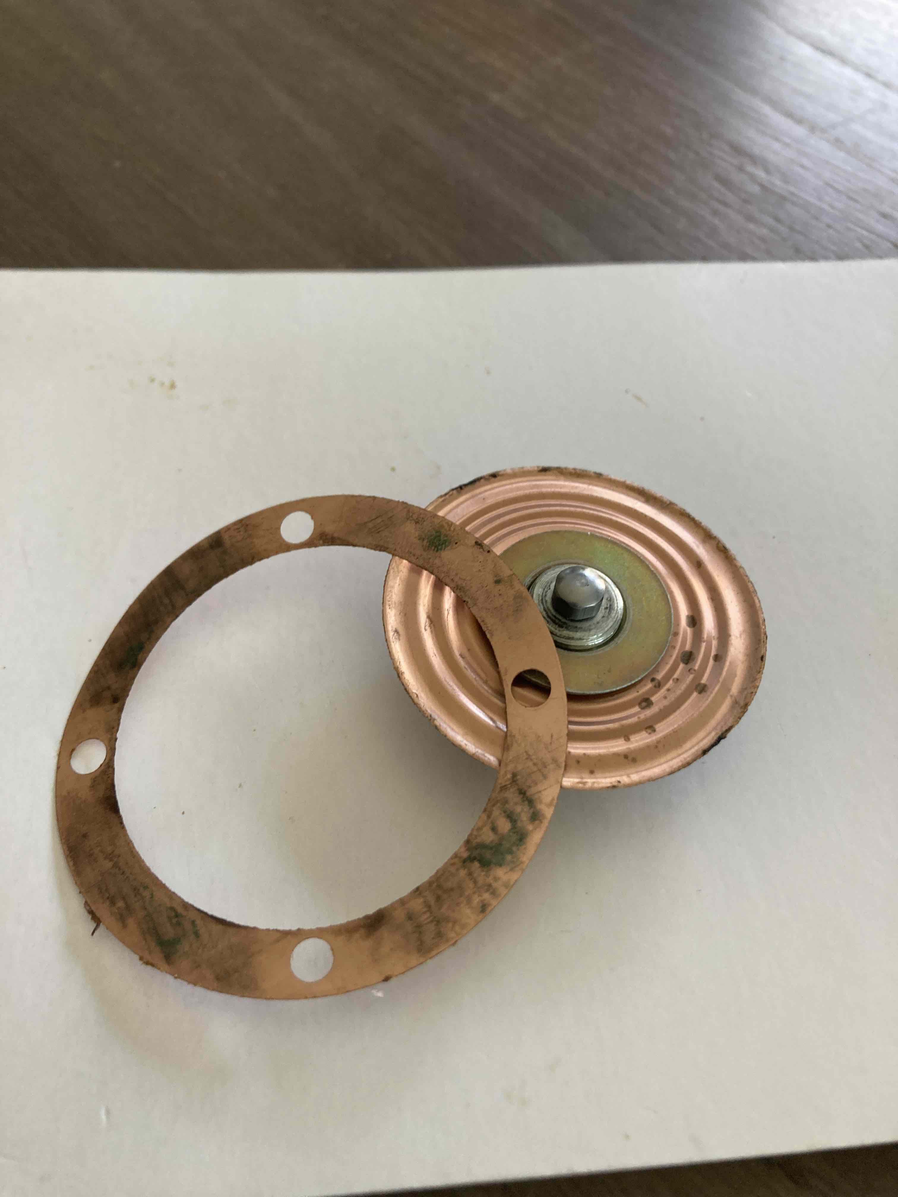

FlacaProductions   Here's the pics. First time I've had one o...   Aug 20 2025, 04:50 PM
FlacaProductions   RE: Did altitude just blow out 2 MPS's?   Aug 20 2025, 04:50 PM
FlacaProductions   AND....how do i put it back together?!   Aug 20 2025, 04:57 PM
rjames   If the diaphragm isn't cracked and the seals a...   Aug 20 2025, 05:06 PM
FlacaProductions   I could use some of that tequila right now.   Aug 20 2025, 05:17 PM
JeffBowlsby   Post photos of the front/back of the diaphragm ple...   Aug 20 2025, 05:20 PM
emerygt350   You can test if the cell is doing what it should b...   Aug 20 2025, 05:33 PM
FlacaProductions   I don't see any breaches. I've held it up...   Aug 20 2025, 05:51 PM
ChrisFoley   I've gently flexed it all around and don...   Aug 20 2025, 06:09 PM
FlacaProductions   No cracks. I would think that it’ll tear or clic...   Aug 20 2025, 07:41 PM
FlacaProductions   Well. It’s back together and it’s holding SOME...   Aug 20 2025, 08:59 PM
