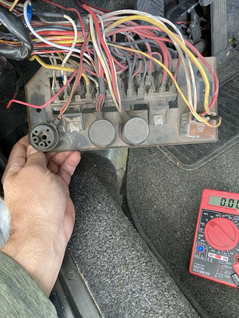

Hello Everyone.
Finally getting back to working on my 1971 914.
When I bought it the turn signals did not work.
The headlights and taillights work. (When key is in ignition and in on position)
I took it out for a ride, and parked it in my garage.
The turn signal stalk was left in the right turn position.
Later that night I checked on the car, and found the right turn signal was on steady.
(Only when key is off car not running)
So, both left and right turn signal light steady when key is off but not when key is on or car running.
Apparently the wiring is not broken.
Can someone help ID the relay for the turn signal flasher on this board its a 1971
If so, does anyone know where I could source one?
Thanks everyone...

QUOTE(dtmehall @ Aug 21 2025, 08:32 PM) *
Thanks for the pic
This is the board in my car now. the previous pic was off the internet..

Spoke   I think you have some custom wiring going on with ...   Aug 21 2025, 08:32 PM

Spoke   Thanks but the pic you are referring to is not th...   Aug 22 2025, 06:38 AM

Mike1981   Hello Everyone Well, my life has finally settled ...   Nov 4 2025, 09:22 AM
Spoke   Not sure what that relay is. It doesn't have t...   Nov 4 2025, 09:54 AM
Mike1981   Not sure what that relay is. It doesn't have ...   Nov 4 2025, 10:34 AM
Mike1981   Not sure what that relay is. It doesn't have...   Nov 4 2025, 10:38 AM
Spoke   Great may I buy one from you please? Would I simp...   Nov 4 2025, 01:40 PM
Mike1981   [quote name='Mike1981' post='3231308' date='Nov 4...   Nov 4 2025, 03:20 PM
Superhawk996   The only thing I can add is the photo in post #1 w...   Nov 4 2025, 08:07 PM
